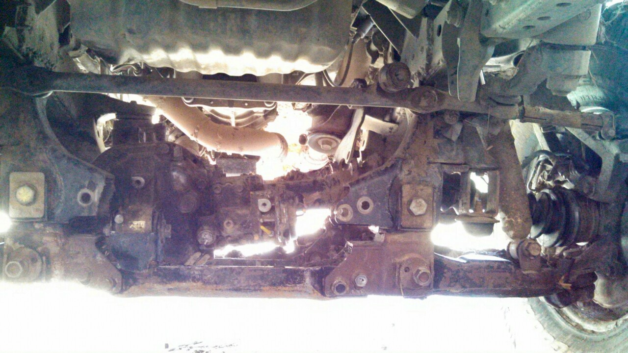

I know this is an old thread but it is the only place where I've seen this.the same thing happened to me, only the drivers side mount was torqued and I had to cut it off and reweld it to the frame. Though in my case I think its due to the bracket lift and v8. Will add a picture tonight.

If it was me I would try and get a new bracket. weld it and it could let go again in the heat effected zone just from metal fatigue.
If this broke once was it because the bolt had gotten loose??
Sometimes you need to make do with what you have.
