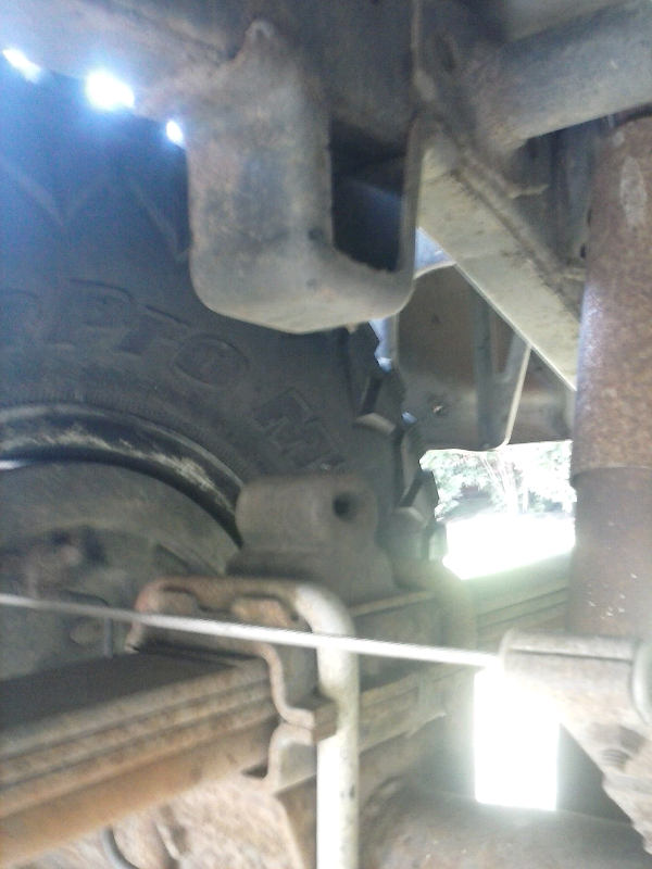

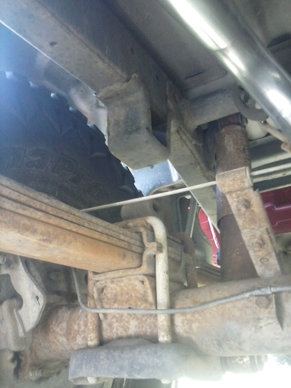

Old Oct 1, 2013 | 03:40 AM
JakeMcGuire's Avatar
Joined: Sep 2013
Posts: 127
From what i can tell, I'm sagging pretty low anyway, so to rephrase; what should i be looking at to get me 2-3" over stock?
Old Oct 1, 2013 | 03:58 AM
Yamiryder's Avatar
Joined: Aug 2012
Posts: 319
From: Punxsy, PA
2" rear lift springs would be the best. I have a 2" rear block, but i don't recommend as it interferes with the e-brake. If not wanting to spend the money for the springs, you can also get a 2" longer shackle, which is what i'm going to do soon. Can also do an add a leaf, but by far the best option is new spring. And on 33x10.50's, basically have BFGoodrich, Toyo, and Interco to choose from...kinda lengthy post sorry
