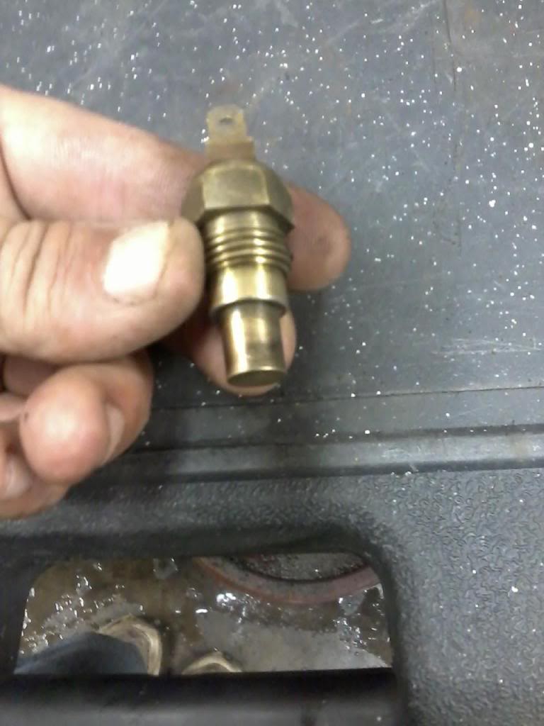

I have had the temp guage to jump up even when it has been sitting for a long time. Here is how I fixed mine in the pic below. I also suggest cleaning your Cold Start Injector Timing Switch and Water Thermo Switch while at it.
Copied...
Here is a picture of a dirty Temperture Sensor. I have seen worse. I chipped some of the scale build up off so you could see a difference.
The sensor sits just below the Cold Start Injector in the Intake manifold. Uses a 17mm deepwell socket and is a 5 minute job.
