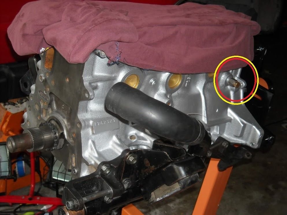

Potential Location for after-market temp sender with with temp reading display.
Originally Posted by MaK92-4RnR
I personally wouldn't trust the factory gauges. I installed a water temperature gauge on my 3vze and haven't looked back
I wanna do this. Couple of questions...
1)Did you replace the sender with the gage kit you got, or
2) Is the display compatible with stock OEM sender?
3) Or did you install new sender elsewhere? Port below, originally shared by Chefyota4x4, looks good. I believe it would always be in contact with the coolant.
Tnx!

Image doesn't load here. If it's on the intake yeah it sees engine coolant always.
You could always paint lines and numbers on the factory dash based on the temp/resistance chart ;-)
Uploaded photo on post above.
Sucks that Google Photos do not work well with Yotatech. On the other hand, when I upload my pics to Yotatech albums for easier organization they disappear.
Like me, an engineer, MaK92-4RnR probably wants actual numerical display, instead of plain Cold, Hot, Too Hot.
Oh the block drain, that makes my thermocouple line plenty long enough to use.. I have a three guage setup mounted to (OK it's not really mounted, it just flopps around on the console..) At the base of the dash. The supplied line for water temperature is just to short, to make it reach the radiator the guage would have to be outside on the hood or maybe on top of the dash and a hole drilled in the firewall.
