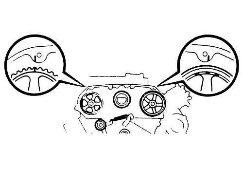

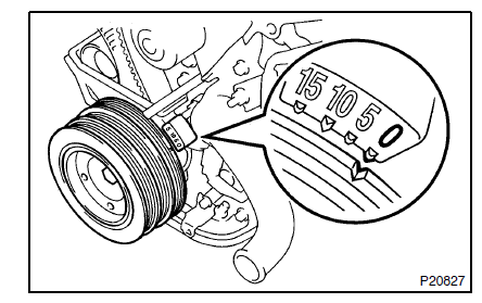

TDC will not stop the cams from jumping.
TDC is easy on the 3.0..... Line up the mark on the each cam with the mark on the backing plate and the mark on the crank gear with the mark on the oil pump. Bingo......TDC.
This engine is non-interference so if the cams jump, and they likely will, you can rotate them the back to TDC without any harm to the heads.

rworegon has it right. The pressure of the valve springs will cause the cam to move a few degrees once the belt slacks, but don't worry about it. Just turn the cams (if necessary) when installing the belt, and make sure the marks line up once you re-apply the tensioner pressure.
If your case, you will be careful enough that the belt won't come off the cams when you replace the water pump. When you tighten it back up, everything will move back into place.
