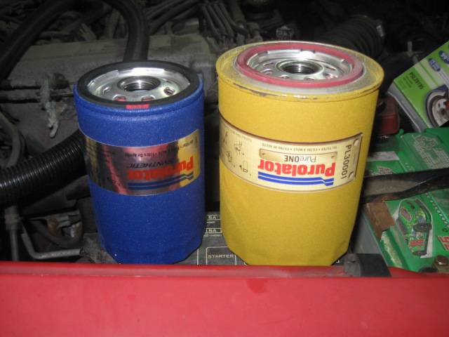

I just changed my oil in the 4Runner and I used the new synthetic media filter from Purolator, the longer PSL20195. I have been using the longer filters from K & N and Mobil for awhile now. I also bought a PL30001 and put it on to try it...like a glove. I use a Filtermag on my filters and since I didn't have one to fit the 30001, I went with the 20195. I took pictures but I'm having a hard time getting them off my card. As soon as I download them, I will post them...

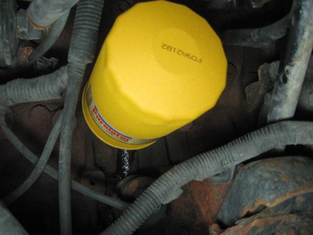

Here is the pics of the PSL20195 and the PL30001 side by each. The gasket surface is just about dead on. The third pic is the 30001 installed loosely on the block for the picture before I took it off and put the 20195 on because I had the Filtermag for that size.
Attached Thumbnails Tall oil filter .vs. Small oil filter-phpjduhjapm.jpg   Tall oil filter .vs. Small oil filter-php9e696ipm.jpg   Tall oil filter .vs. Small oil filter-phprj6f8upm.jpg
