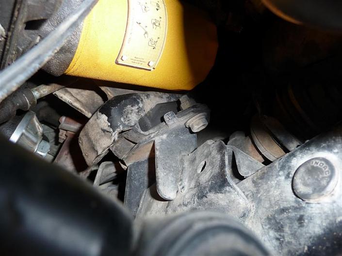

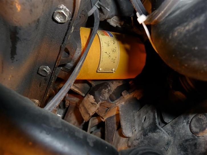

Here is the PL20195 on my '89 3.0. The closest point of contact is with the motor mount bolt at the lower front point of the filter. There is still about 3/8" clearance and there is no rubbing anywhere.
Bugs

Thanks for the pics bugs. Your set up is a bit different than mine. Putting this filter on, it brushes up against that bolt and scrapes a bit of the paint off the filter, thats how close it is. I'm concerned continuous contact with that bolt may eventually wear a hole into the filter. I'll keep an eye on it.

I have the same clearance with the PL20195 as bugs. The bolt that it is close to is in the bottom part of the mount... in other words, attached to the frame. Since the mount is rubber in the center and allows the motor to move some, I've been concerned, but like bugs I've never seen any evidence of touching or rubbing. T4R 4ME, I would definitely NOT use the PureONE (or any filter) if it touched a portion of the frame. You inevitably will wear a hole in the filter. I'd suggest using the Toyota 90915-YZZD3 instead, which is still taller than the stock filter with 27% more filter media area, but about an inch shorter than the PureONE, so it should clear no problem.

Then thats got to be the motor mount that I'm looking at...I didn't look too closely to what it is, just noticed that its close to the filter. So close, that it does actually rub against the filter when I'm screwing it on. There is some clearance, but its a couple millimeters at best. I'll keep an eye on it and change it out if I need to...don't want to cause another oil spill.

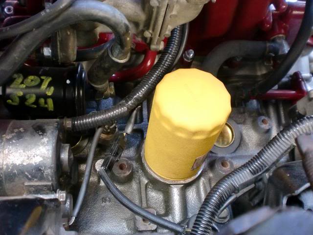

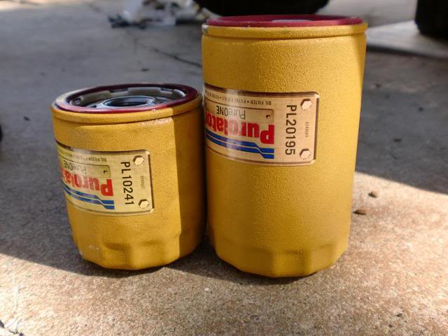

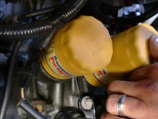

Just changed over to the taller Purolator PL20195 from the shorter PL10241
Here are some pictures from my 90 for you guys with a 22RE...No problems with clearance
Oh I know its a older thread, but didn't need to start another one
