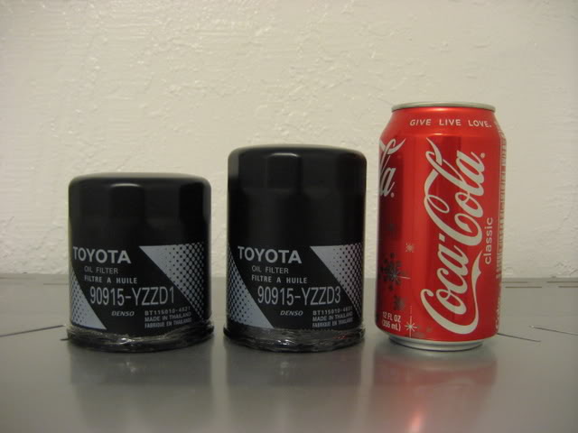

The Toyota filters page linked above (and here) looked specifically at the filters for our engines - it's the only study (I think) of the bunch that did that. It revealed something interesting: because of the different bypass and anti-drainback valve designs, there was a huge variation in filter media area. Turns out that the Wix/Napa Gold filter has MUCH less filter area (104 sq in) than the Toyota filter (160 sq in). So much less, it seems it must have significantly less service life before it clogged and oil just started bypassing the filter media.
So if using the small size filter, it turns out the Toyota 90915-YZZD1 actually IS better than any of the aftermarkets.
I think that really highlights your original question, 8lugnuts: would a taller filter be better? I think that if the taller filter fit, and it had filter media equal in quality to the Toyota (synthetic, not paper) and if the bypass & anti-drainback valves were of good quality, and if it had more than 160 sq in of filter media area, then, yes, a larger filter would probably have a longer service life and probably also would have less back-pressure, especially as it got dirty.

I forget now who makes them, but I heard a lot of good things about the Walmart brand Supertech filters. Maybe it was Champion or something. I know for sure wally world doesn't make them themselves...
Anyhow, I've run the St16 for years and it's twice the size of the 3614. It's the one from the ford motors mentioned and I think it cross references with a purolator ph16. They switched to the new core a while back so it isn't much longer than the 3614, but it's still almost twice as big around and has about 200% more surface area than the stock 22re one does. Anyone that has spent time on the BITOG forums can appreciate the higher rate of flow the larger filter gives over the smaller ones. Plus as mentioned they take longer to clog. I used it on my truck and still use it on my '03 4runner V8 motor too. Capacity went up about .5 quarts over the stock one.
Last I heard, Bob wasn't running a filter at all. If you want to read on this subject until you're numb, google Bob is the oil guy and read the filter forum. Those guys over there spend way to much time thinking about oils, intervals and filters.
Here's some pics I took a while back. Keep in mind the bigger one has the mesh core in it and used to be twice as long as the smaller one...

ovrrdrive, thanks for the pics and report. The Walmart Supertech ST 3614, I see, is a replacement for the spec Toyota filter, the compact-sized 90915-YZZD1. The Supertech is made by Champion Labs, and is their economy "Ecore" design. It uses thin felt endcaps that separate quite easily from the filter pleats. It lacks a separate bypass valve. The filter media is paper, not synthetic. The identical STP filter, also a Champion Ecore, has 110 sq in, so, they're similar to the Wix/Napa 1348 (104 sq in) and the Purolator PureONE PL10241 (107 sq in). All well below the 160 sq in synthetic media Toyota YZZD1.
Info on the Champion "Ecore" design on these pages:
http://www.300cforums.com/forums/gen...dissected.html
http://minimopar.knizefamily.net/oil....html#champion
It's great to know that the larger sized Supertech ST16 fits on the 22RE since it is the same width and gasket diameter as the jumbo-sized Wix 51515 and Purolator PureONE PL30001 mentioned in an earlier post. The difference is height: the ST16 is 3.2" tall while the 1515 & PL30001 are 5.1". The Wix equivalent to the ST16 is the 51085 (NAPA GOLD FIL 1085) and the Purolator PureONE PL14670.
So, if the larger height is not a problem, it sounds like the jumbo sized filters would fit on a 22RE. I still hope to learn if they will fit on a 3VZE.
What's really interesting about that larger Supertech ST16 is that it has almost the exact same filtering area as the compact Toyota YZZD1: 185 sq in vs 160 for the Toyota!
The ST16 equivalents from Wix (the 51085) & NAPA (FIL 1085) are even a tiny bit worse at 172 & 184 square inches respectively. The Purolator equivalent, the PureONE PL14670, is a bit better at 242 sq in.
So it would be worth it to know if the jumbo sized Purolator PureONE PL30001 would fit, since it has 400 sq in. The jumbo Wix 51515 has 349 sq in and the Napa Gold FIL 1515 slightly less at 337 sq in. Also, the PureONE has synthetic media while the Wix/NAPA uses a paper & glass fiber media, and the PureONE has very high filtering efficiency while the Wix/NAPA has middle-of-the-road efficiency.
BTW, while the economy Ecore design from Champion Labs is (imo) a poor quality filter, their performance design is not. The Mobil 1 and K&N filters are performance design Champions. The Mobil 1 is often cited on the bobistheoilguy forum as being as good as or better than the PureONE in filtering efficiency. Any filter that has a high efficiency is at risk of having poor flow characteristics, so it's better to get a larger sized filter if using one of those brands. The PL30001 equivalent from Mobil 1 is the M1-301 which has 356 sq in and the K&N HP-3001 has 362.
It sounds to me like the Purolator PureONE PL30001 would be hard to beat if it fits.
