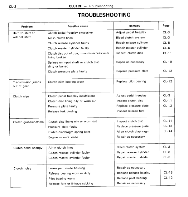

Hi guys!
My T4R's getting harder to shift, I noticed it in the last 100 miles. I don't have to apply force, it just feels like it grabs more when going into first and second gear and reverse, I have to push the clutch pedal to the floor and slowly shift gear.
I replaced all gear fluids when I got the truck, around 1500 miles ago. I put Castrol Syntrax Universal Plus 75W-90 in the transmission and transfer. That fluid fits the FSM specifications. The level're ok.
I'd like to solve this issue, what do you recommend me to do?
Thanks!

Are your master and slave originals or have they been replaced? Maybe bleed the clutch to make sure you are getting maximum engagement. I believe you can also adjust the rod on the clutch master that sticks thru the firewall to get a bit more travel out of it...in case yours hits the floor before bottoming out.

Hi @coryc85.
The master and slave are the original ones.
I should bleed the clutch to be sure.
A little detail I just remembered, the clutch pedal started to make a sound for a few days a month ago, a slight squeak everytime I pressed/pushed it. I couldn't here it anymore after 3/4 days. Maybe the problem's related to the pedal, I'm going to check that.

Hi guys!
I found a leak in the master cylinder, only a drop under the M.C. boot (see photo, inside red circle), nothing in the carpet, as far as I could see. The reservoir level's in the middle.
I also checked for clutch bracket fatigue in case that is the cause of the problem, but I can't see anything broken in there:
https://www.yotatech.com/forums/f116...fatigue-32667/
Do you think that is the problem? What do you recommend me to do?

Well, I know if that were my truck, id order a new Aisin master and slave, and probably clutch slave soft line as well.

Hi guys!
Update: I replaced the master and slave clutch cylinder and the fluids in the transmission and transfer case, but this time I filled them with Amsoil 75W-90 API GL-4. Problem solved.
Thank you guys, thank you very much!
