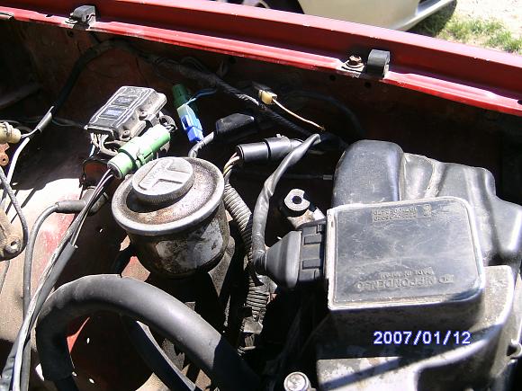

heres my drivers side( behind fuse box) and pass side(where plugs should be)

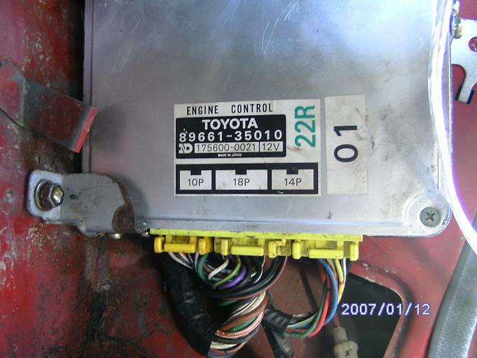

this is my 86 ecu. is shows a 10prong spot, a 18 prong spot, and a 14 prong spot. thats the same as my 88 ecu.
i should be able to tap into it- IF i can trace which wires are te1 and e1 from the bottom of the ecu to the harness in the eng compartment. RIGHT??
im not even gonna attempt this until im sure it will work. there arent enough toyotas around here to just go get a new harness. not even in junk yards. the closest one i can find is two hours away!

Originally Posted by yotarunner87
hmm. so the 86 ecu wont have the wires coming out of the bottom of it would it? if it did what thook said would be easy nough.
any ideas on how i can fix this?
im afraid if i start hacking my harness up ill end up with it in the trash can! im gonna get pics of my engine compartment up right now
There has to be wires/terminals for testing purposes at the ECU that would otherwise go to a diagnostic port or plug or else you couldn't trigger the ECU. I think what DeathTulip is trying to say is that the two wires (T and E1) run from the ECU, but are/would be grouped with the '86 chassis harness to be able to run it around to the driver's side as opposed to under the manifold and that general area. So, you'd have to look for the wires to be group with headlamp wires. With that in mind, and given your swapping around from year model to year model, your wires in question were probably cut somewhere near the ECU where they'd split off from other engine/EFI wires?
I will look at my '86 this afternoon and get back about it a little later today. I simply don't remember offhand how they're all run. Never paid much attention to that little detail. But, for some reason I'm thinking the two wires might actually be grouped with the wires to the ignition coil and igniter. Not sure. I'll just have to look.
Attachment 83028
Attachment 83029
Attachment 83027
Well, don't worry. I'm sure we'll locate the wires. They have to be there somewhere.
For the moment, yes, you could simply find the pins at the ECU and tap in a wire at the back of the corresponding terminals on the connector with the connector, of course, connected to the ECU. That is until you locate the business end of the wires.
That would be what i would do... any book should show a pin diagram for the ECU.

On my '86 4rnr, the diagnostic wires run along with the headlamp, coil, and some other wires......starting at the fuse box, across the radiator, and split off on the driver's wheel well. The engine harness comes from inside the firewall, pass. side of course, and over to the manifold. But, there are two wires that split from the harness, run to the silver aluminum thingamajigs next to the fuse box, and then to the fuse box. Unless I missed something obvious (I was kinda in a hurry), I don't see how else a/the diagnostic port connects to the ECU except the two from the harness, to the thingamajigs (someone please tell me what those are), and ending at the fuse box. Maybe it connects somehow to the main relay? I'm just guessing there, as I didn't have time to look closer.
Anyway....
I think someone else is going to have to advise you on where you stand with the wiring on your '88 truck (or is it '87?....<<<snort, snicker>>>). I don't know how everything runs or how to make something work for you without actually seeing the vehicle better. Logic tells me you could simply splice some wires in behind the connectors at the ECU and run it out the firewall with the rest of the harness. It's backyard style at it's best, but it would work. That is only for setting timing and atleast pulling codes, though. Testing fuel pump, oxygen sensor, open/closed loop operations, and anything else....I don't know. Sorry.
You might try pm'ing ChefYota4x4. Get him to chime in. He has an '88....

i am gonna try to find the wires you mentioned tomorrow. the two silver things on the pass side are relays for the starter( at least one of them is? i think anyway hehe)
if those two wires dont work, ill look at the pins on the ecu and trace the wires on the harness and tap into them in the eng. compartment. sounds easy enough now. i just didnt wanna screw my harness up.
