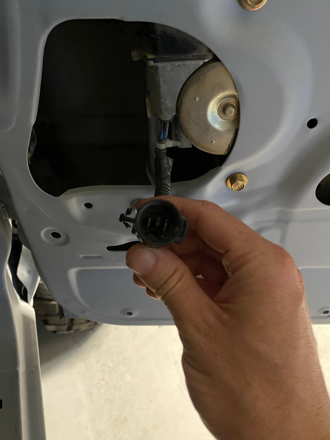

I have a frame off build. Bought these door with auto windows. Looking for switches, however I haven’t come across ones that have this plug.
Does anyone know what switches go to these types of auto window plugs?

Year/model/trim of the truck? Year/model/trim of the donor vehicle the doors are off of?
The actual metal wire terminal can usually be de-pinned and plugged into another style plastic housing. Sometimes this will help you mix and match parts from other Toyota vehicles without having to hack up harnesses and plug.

You're missing (atleast) a sub-harness here.
In my 86 SR5 there is a sub harness between the door light and window switch, upstream of this sub harness in the door harness is the connection for the window motor. You're probably missing the door control relay also, it's not super important but it allows you to run the windows up and down for a short time after the ignition is switched off.
Don't forget to wire up your window motor circuit breakers...

Thanks for the info. I will be on the look out for the sub-harness and all the other parts.
