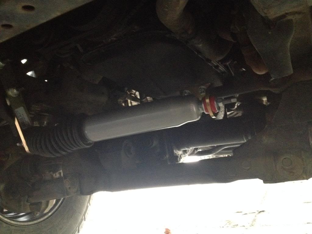

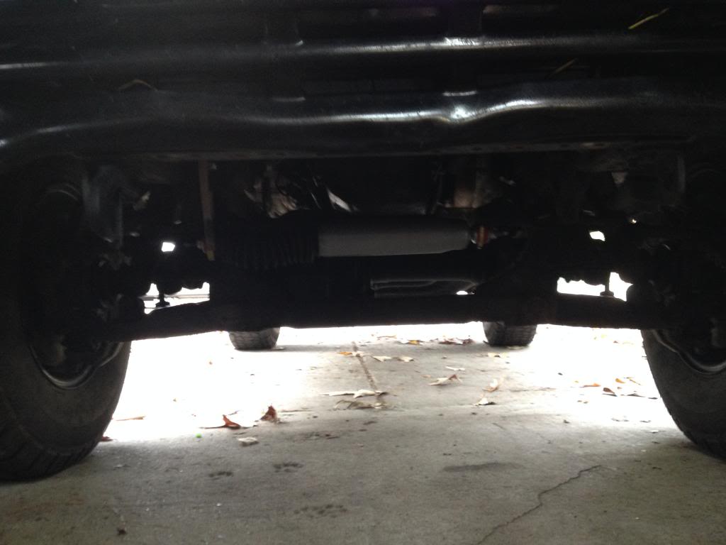

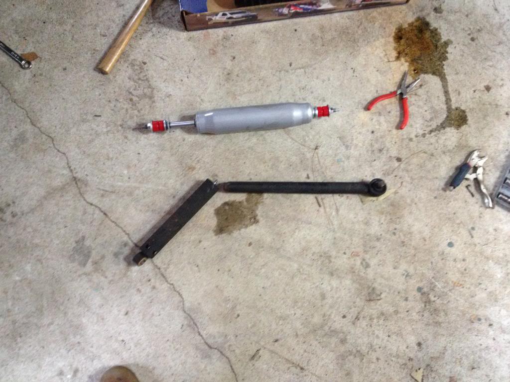

Just changed out the Steering Stabilizer. The OEM unit was broken, the shaft sheered off inside the shock body. Drives much better now, but still have a slight shimmy when applying the brakes above 45mph. All of the TRE's looked good. I might have to try new rotors next. It was super easy to install and setup!
Here are a few pics-
