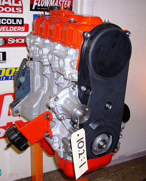

Old Aug 21, 2009 | 03:28 PM
  #26
22REw/HP's Avatar
Joined: Dec 2008
Posts: 105
From: PNW
Originally Posted by iamsuperbleeder
holy crap man, that thing sounds MEAN!!!
nice work man! she sounds like she runs great!
even though you are a color-theif lmao, just kiddin man
nice work!
all of ya'll is color theives!!!!!!!!!!!!! lmfao
chrysler red is the hit!!!!!
