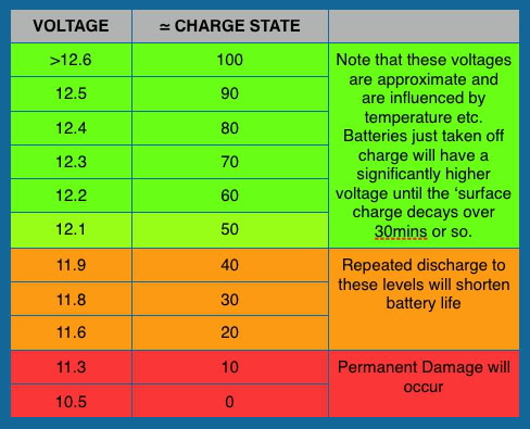

How can your battery not be dead if the alternator voltage was 10 volts? What was the battery voltage? Look at this chart:
A battery at 10 volts is BEYOND dead, it's destroyed.
