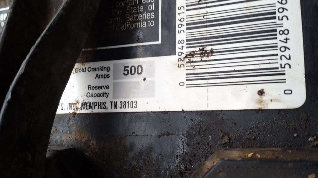

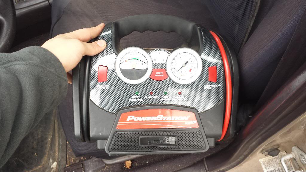

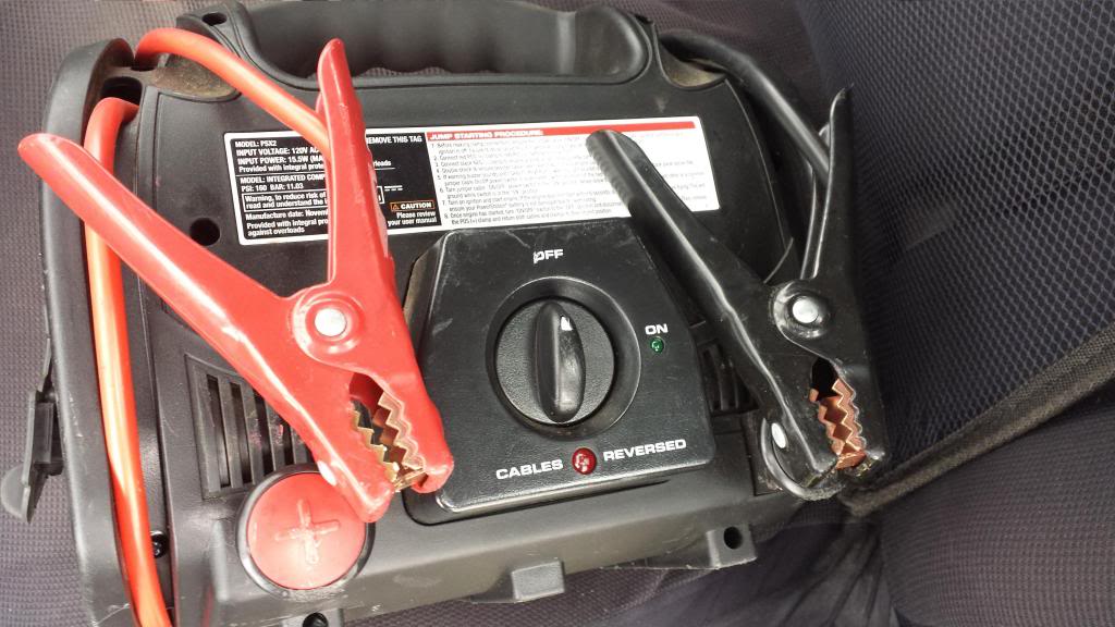

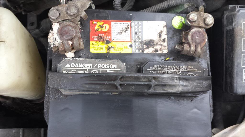

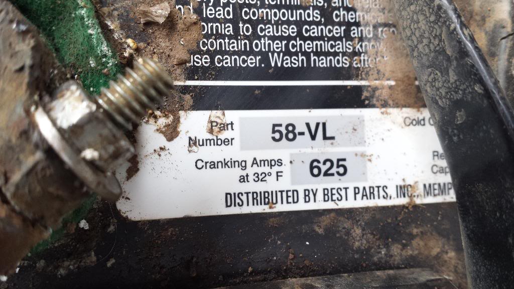

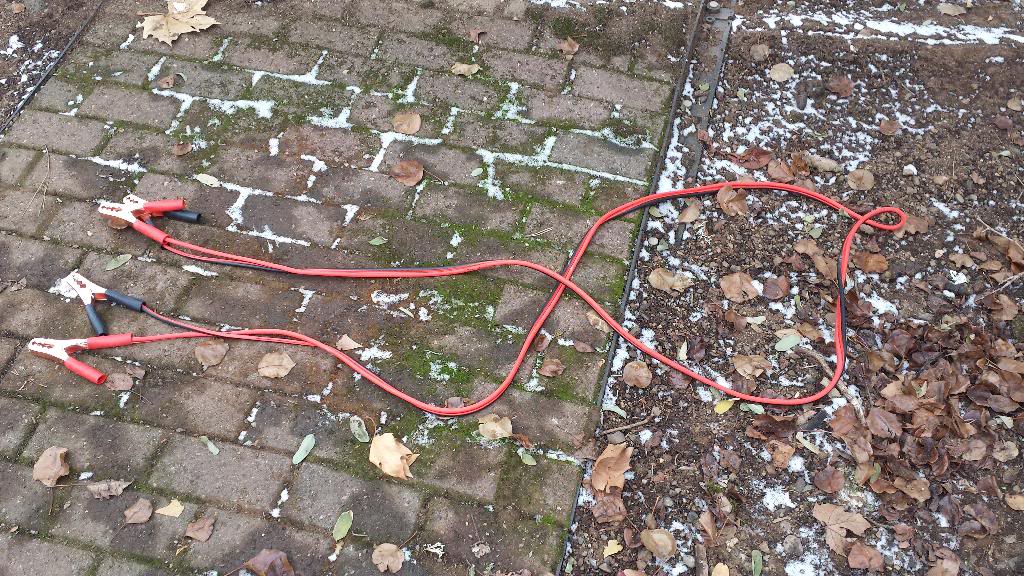

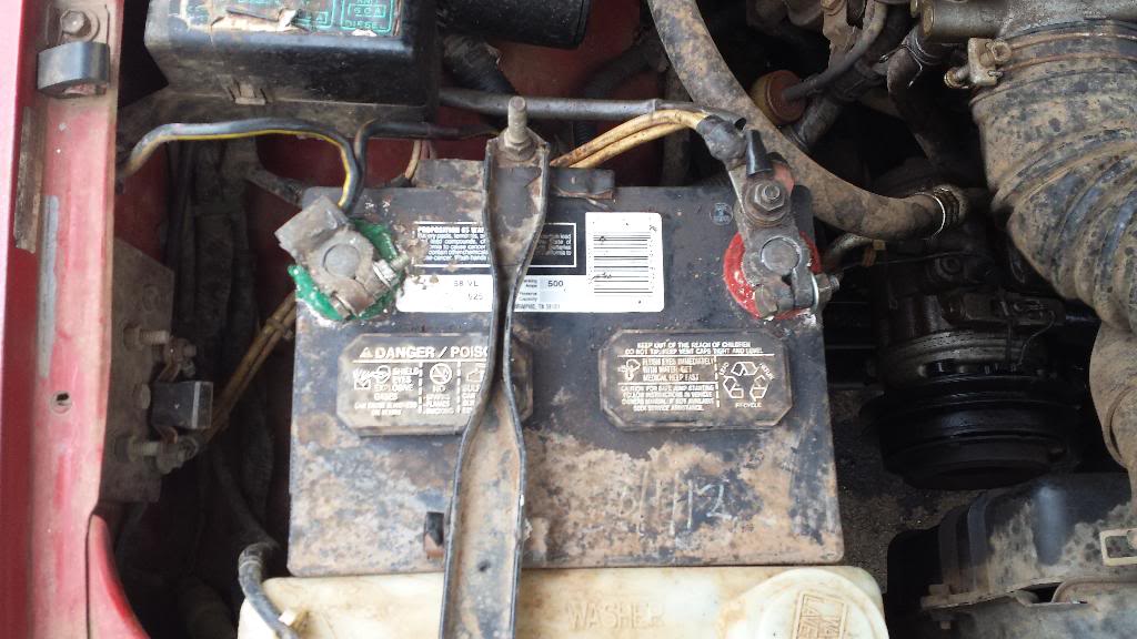

Ok so here comes the photos..
4runner battery - VALUCRAFT (part # 58-LV)

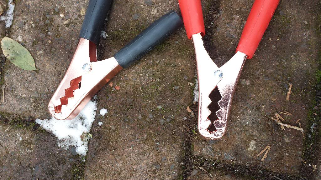

Jumper cables - car and driver 10-12'
Battery jumper - awesome little thing to have

Does anyone know if this battery is small for the 4runner or it it fine?
Old Dec 10, 2013 | 01:50 PM
SPARKS89's Avatar
Joined: Feb 2012
Posts: 654
From: Earlysville, Va
Originally Posted by 1stGenYoda
Ya I rev'ed it a couple of times while trying to jump.
The battery in my truck has 550 CCA and it's got plenty of power to do the job.

hmm, well im pretty sure my corolla battery needs to be charged... I got a bad connection that like to come loose and havnt fixes it yet.
Is there a way to get a discount on a bigger, better battery if I trade in my current one? BESIDES the core exchange. (Im planning some lights and what not so more power will be needed)

Many things:
1. Battery in your truck is WRONG. A 58 is generally a battery for most fords. You want a 34 or 24F depending on where the positive is. Looks like a 34 would do the trick. In some cases some toyotas take a 25/35 as well. 34/24F is a 650cca battery in most cases
2. Corolla battery is wrong as well, 35 or 24F. Throw away those replacement terminals and buy new ones as they are old, corroded and likely to snap if you take them off/on.
3. Terminals are all corroded and dirty. Baking soda and water then a wire brush
4. Cables, those are cheap chinese crap. Buy ones with the thickest wires possible.

Ok. Size of the battery only matters in how long the battery will last without being charged. So yez you dont have the correct bTtery in the truck but 600 cold cranking amps is enough.. thus the battery is powerful enough to start the TRUCK AND JUMP SMALL TO MEDIUM ENGINES. Sry bout caps..
Again get a better pair of jumper cables.. not just thick ones but fibrous. For example someone above mentioned 20 foot jumper cables made from welding wire. That's genius because welding wire is both pretty thick but more importantly it is fibrous. electrons travel on the surface of the wires so the more wires you have the more surface area you have therefore it can transport more electrons which is more current. Simple test to prove it to yourself is connect your jumper cables to your little jumper battery and try to start a carr with a dead battery that way, it shouldn't work if it doesn't work with your car. But I'm sure if you connect your little battery jumper directly with short cables it will work.
Thanks for the correct batteries, and the corolla battery is probably corroded because the bad connection, the wires are too short and need replaced along with the connection to the terminals.
Ya my 4runner is sitting with the battery with 500 CCA so that will need to be replaced sooner or later haha, and ill be on the look for some welding wire to make some cables.

what is on your fender that the 2 beige wires are running to from the positive battery terminal??
