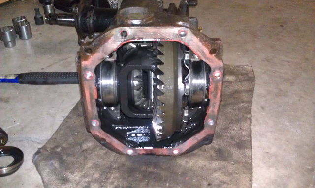

Sadly I'm still running the ifs system for now. The odd thing is it looks like it should just slide out. But I don't want to get to forceful with pursuading it.

This is what I'm looking at atm.
Old Apr 24, 2013 | 05:57 PM
Toyota~Boy's Avatar
Joined: Oct 2006
Posts: 1,514
From: Kenna, WestVirginia
That's correct. Just pry it out. You won't hurt anything

Cool thanks I will give it a go when I gear home.

if you have a vice and a friend that doesn't mind catching, hang it upside down, loosen the pinion bolt to the last 3-4 threads and hammer with a punch (to not damage the threads, and get around the yoke/flange) a couple solid hits (manly hits or angry woman hits) don't baby it, they can handle. and it'll pop out. good luck!

Got it out! Thanks again you guys no I can replace the trashed bearing.

Glad you got it out. In the future, and for others who are struggling, there's an easier way to get the carrier out. Once you have the axle stub shafts out and the bearing caps off, just wedge a 2x4 alongside the carrier so it can't turn, and then start cranking on the pinion flange. It will jack the ring gear and carrier right out of the case with almost no effort. You can also just wedge a folded shop rag in between the ring and pinion gears and get similar results.
I just had my front IFS apart a month ago to install an Aussie locker, and the 2x4 trick worked like a charm. I learned it by reading back articles on this forum.
That trick doesn't work to reinstall the carrier. For that you'll need a big hammer and block of wood to persuade it to go back in. Like was said above, don't worry about being forceful with it. When you're geared down in first gear lo-range, the engine is putting far more torque (to the tune of about 3-4000 ft-lbs) on those parts than you'll ever be able to generate with hand tools.
