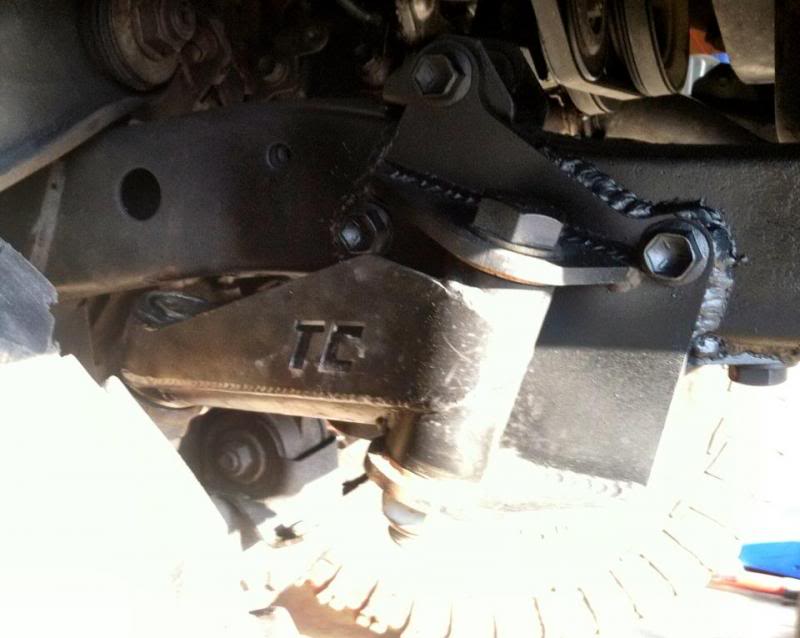

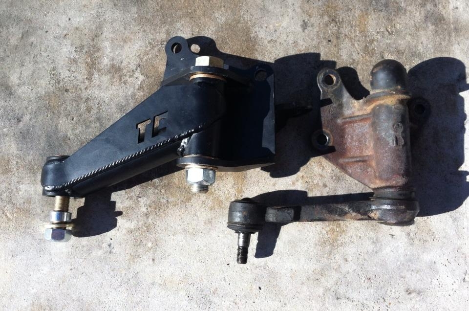

After snapping a idler arm on my last 4runner and already bending the idler on this 4runner, I decided to drop the money on a Total Chaos Idler arm for the piece of mind on the trails. Here's the TC idler next to my stock idler.
The only modification you need to install the TC arm is boring out your center link to 5/8". Here is the idler installed!

After I got it installed, I decided to go take the 4runner on an shakedown run to test the idler arm and radiator. I took it easy other than a rocky hill climb I decided to try.
Like usual the picture doesn't do the obstacle justice! It's steep and some of those rocks are decently large. After a few runs at it dual locked and at street pressure, I only made it 2/3 of the way up. I probably could have made it if I aired down but didn't have my compressor and my truck was starting to overheat (I believe because I wasn't running a radiator shroud) so I just called it quits and will be back another day.
The TC idler set me back $351 from Kartek, bringing my build total up to $4703! The only thing stopping me from really wheeling this thing is a rear bumper, once I get one of those I'll really be able to beat on this thing!

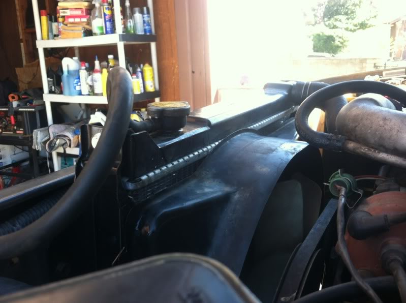

For the past few days I've been calling around everywhere looking for a V6 radiator shroud with no luck. Unlike the metal radiator shroud on the 22re, the V6 shrouds were plastic and seem to crack over time. I considered buying one new, but figured I'd play see if my 22re shroud would work instead. After a few small tweaks, the shroud bolted up to the radiator and aligned perfectly with the engine. The shroud aligned with the sides and bottom of the radiator, but there is a small gap at the top of the radiator.
For now I'm going to run it like this, I might just add duct tape over the gap and call it a day!
Ductape it! =) I love ghetto fixes, when I first bought my 4runner the PO had stuffed the muffler in between the outer roll cage and the body, this had rusted a hole in the body (as one would imagine) and was pumping in a bit of exhaust into the cab. I was a bit rushed due a trail run I was going on and don't own a welder so I cut the exhaust off with my grinder and put a piece of dryer hose to point the exhaust at the ground lol. it worked great for that one run but the dryer hose didn't stand the test of time. *wish I had a picture of it*

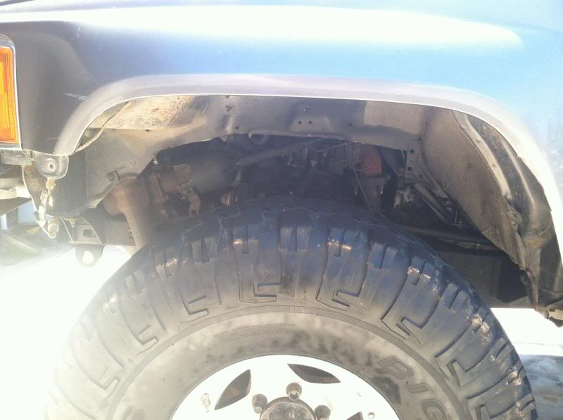

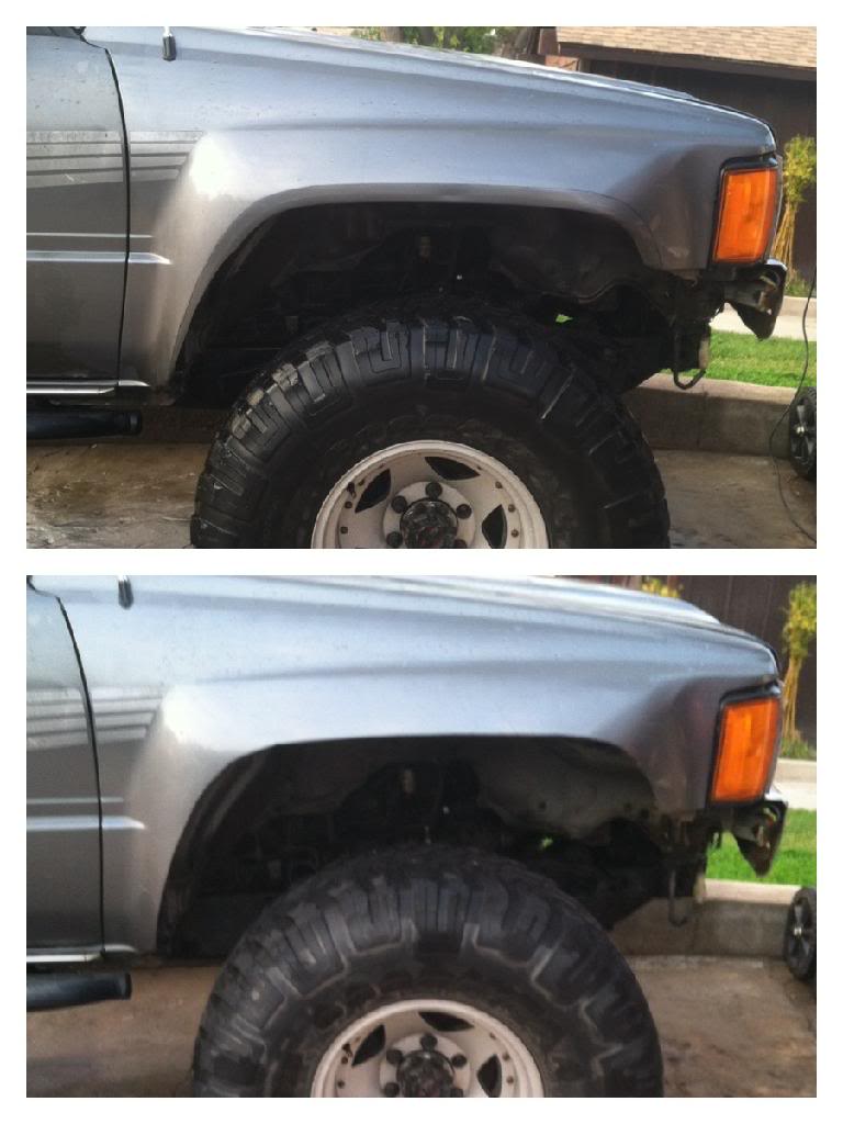

While out doing some light off road testing I noticed something was up with my steering. After checking everything out, it turns out that my Total Chaos idler arm was hitting my frame. One of the main reasons I dropped the $400 for a TC idler arm was so that I could stop worrying about bending idler arms and them hitting my frame. I emailed TC and they advised me to "loosening all of the mounting bolts and trying to rotate the idler arm down, then re-tighten all of the hardware." Although I was able to do that and clear the frame rail, I didn't trust that it would hold up to the forces of off roading so I just decided to weld my total chaos idler arm to my frame.
Hopefully that'll solve the problem!

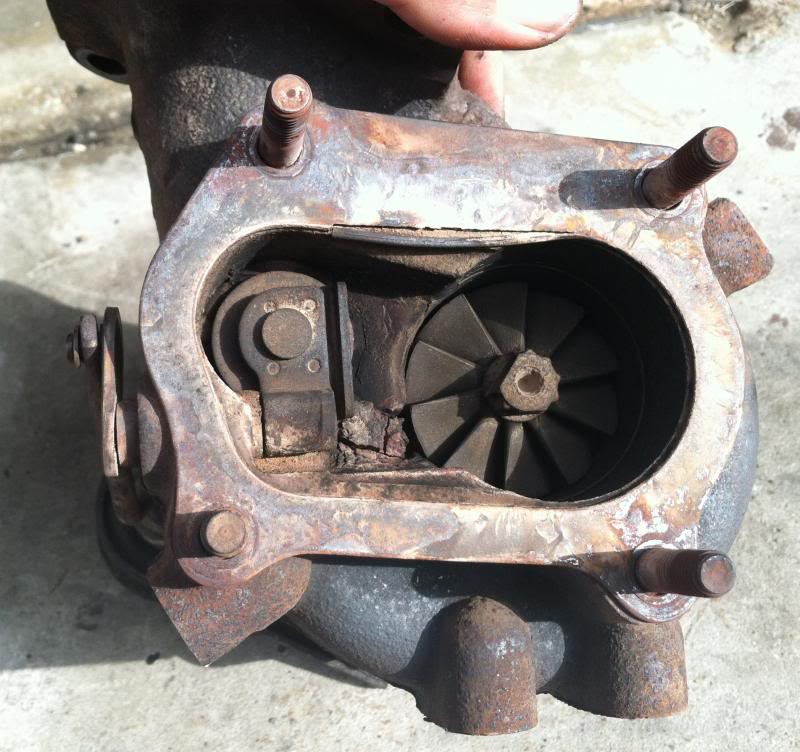

After all the bad things I've heard about the CT20 turbos that came on the 22rte's, I figured I'd pull my turbo and check it out. There was a small crack on the outside of the exhaust housing, but when I got the turbo out I saw this.

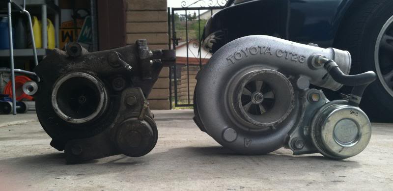

After realizing that my turbo trashed I tracked down a newly rebuilt CT26 turbo from the Toyota Supra on craigslist for $100! I'm still tracking down parts for the swap, but here's a side by side comparison of the turbos.
The stock CT20 on the left and the new CT26 turbo on the right! In the word's of Jeremy Clarkson from Top Gear, "Powaaaaaaaa!"

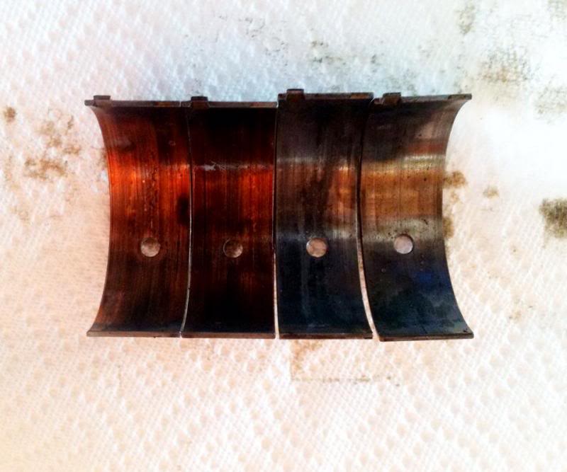

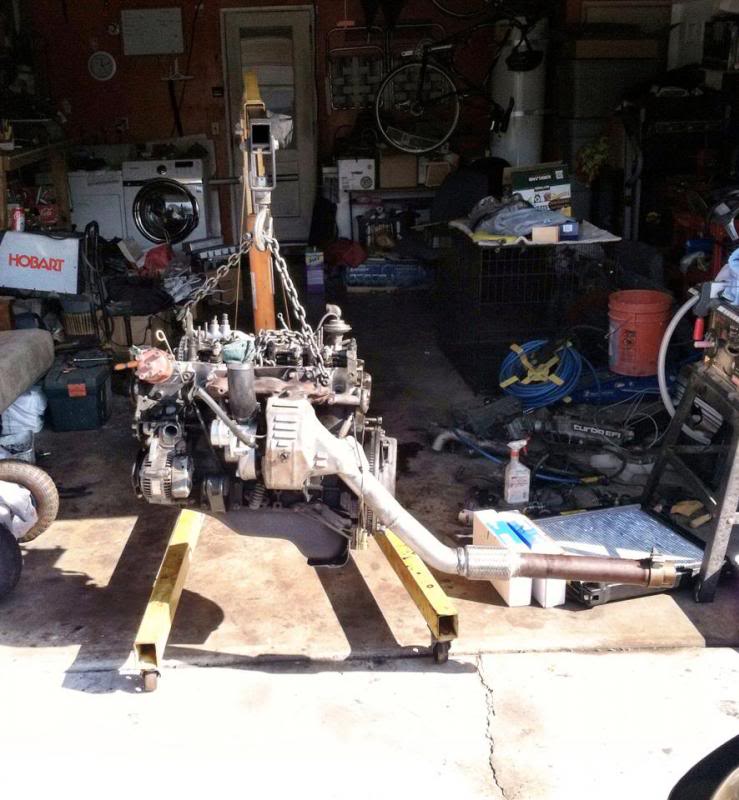

Alright, I've been busy working on my 4runner lately and it's finally a reliable truck! While swapping a Supra CT26 turbo into my truck I decided to bite the bullet and pull my motor and do a complete rebuild on my motor. I always heard a slight rod knock and while ripping apart my motor I discovered I was right.
Looks like this motor was oil starved and damaged my rod bearings. Luckily my crank was fine.
Here's the rebuilt motor complete with the CT26 turbo, custom down pipe and 4xinnovations solid motor mounts.

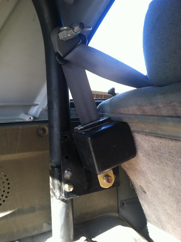

After being in the backseat of a first ten 4runner in a high speed rollover and always seeming to have someone in my back seat while wheeling I turned my attention to my rear seat belts. In my opinion the factory rear lap belts in first generation 4runners suck! They just keep tightening down until you can no longer breath. I had to pick some parts up at the junkyard the other day and decided to buy some shoulder belts for my 4runner. I was hoping to find some from a 84-89 Toyota pickup but had no luck so I just picked up a rear seat belt set from a 96 Honda Passport. Here's a shot of it installed.
Here's a shot of it installed on my roll bar
You can also see my modified 4crawler hi-lift mount to work with the shoulder belts. The ironic part is that I don't even have a hi-lift! I just picked it up at a junkyard for $5 a few years back.
My final verdict, I love them! Much more comfortable than those factory lap belts!

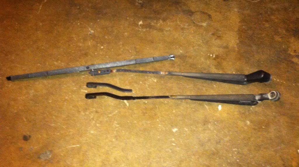

I just got a new girlfriend recently and we planned a weekend snowboarding trip. Since I have the worst luck with snow chains I decided we'd take the 4runner. Considering that she has a brand new car, the 4runner is a little rough around the edges so I did a little work to it before I let her inside of it! haha
Firstly, my windshield wipers are easily a decade old and two of the four mounting screws were stripped out. My solution was to go to a junkyard with a hacksaw, cut off some new wiper arm ends and just weld them to mine. Here's a picture of my old wiper arms on top, the new cut off end in the center and the finished product on the bottom.
My verdict, I love them! No more needing a screwdriver to change wiper blades and now I can just buy any off the shelf wiper I want.

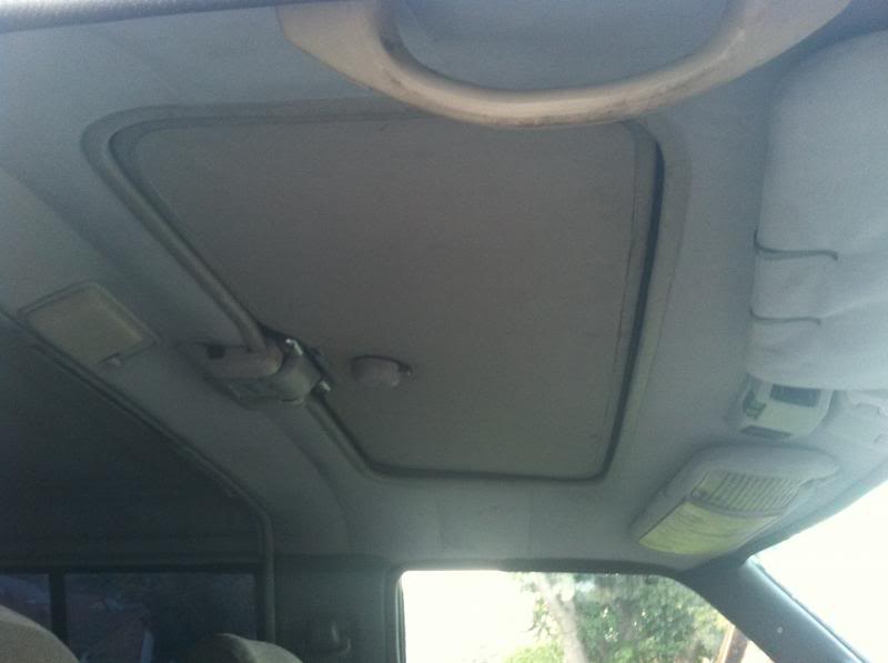

Next up was the interior lighting in my 4runner. I'm not sure if it is because of weak stock bulbs or that the plastic has discolored over the last 28 years, but my dome light sucked. For that I installed an Putco 20 piece LED light panel (Autozone part #980115) into my factory dome light.
Now I can clearly see everything in my truck, including everything on the floor!
Total Cost: The wiper arms cost me $2 and the dome light was another $25, bringing my grand total up to $5,576

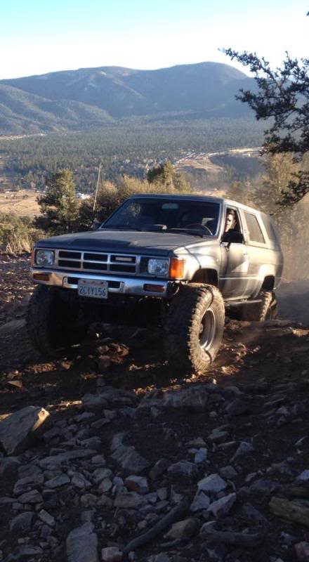

Last weekend I took my 4runner on it's last trip of the desert/snowboarding season! Thursday morning I packed up my gear and my dog and hit the desert for Tierra Del Sol's 52nd Desert Safari! I wheeled a bit Thursday and Friday, but didn't get as much in as I'd like since things kept going wrong. I had one friend roll his Willy's, one friend broke an aluminum wheel on his Rubicon and another friend crack his aftermarket t-case mount on his samurai. So on the bright side, the 4runner held up like a champ! It was my dog Guinness' first trip out to the desert and he had a blast! Here's a shot of him at Font's Point in Anza Borrego!
I got home from the desert Friday night, cleaned the truck out and got a few hours sleep before picking up my girlfriend and taking the 4runner up to Big Bear for a weekend of snowboarding! All in all the truck ran great!
Here's a shot of the stuff I had to drive through that weekend!

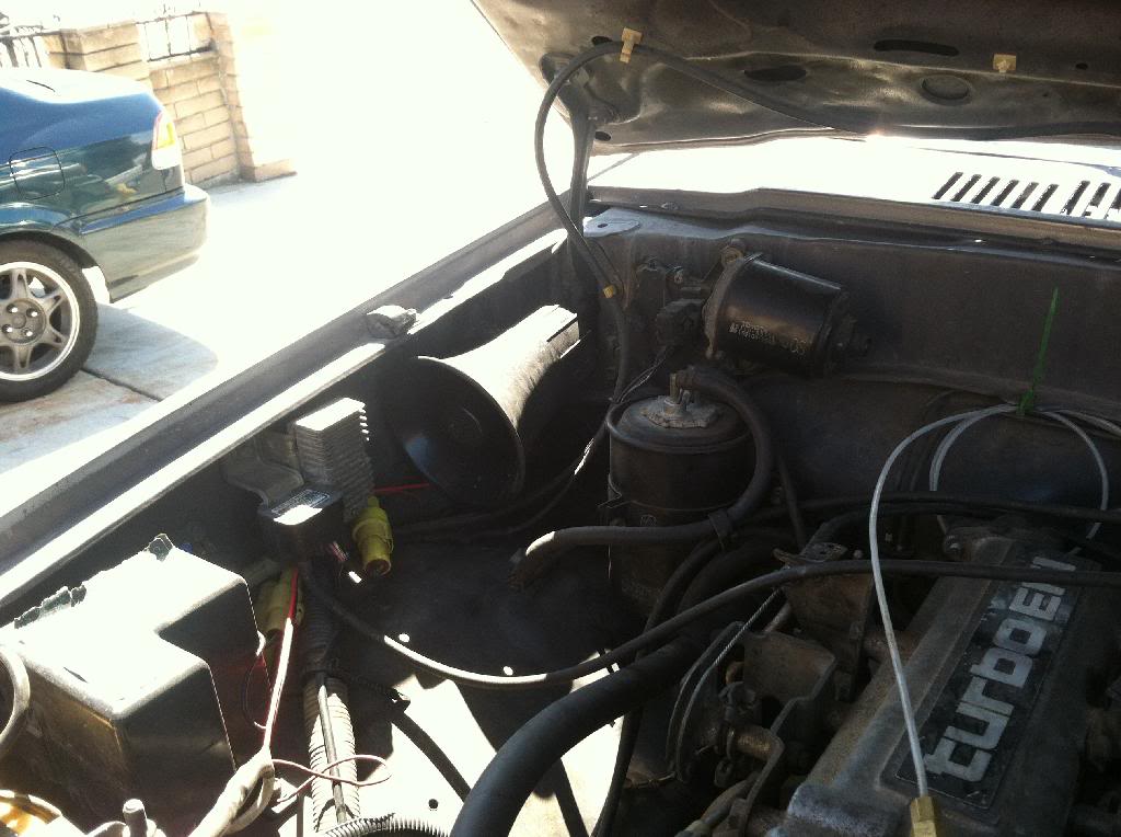

Due to some labor laws I've had a reduction in hours lately so when I got back from the weekend trips I've been working on my 4runner quite a bit the last few days. I noticed my tires were rubbing while off-roading in the desert so out came the sawzall! Here's a shot of my front fender, before on top and after below.
