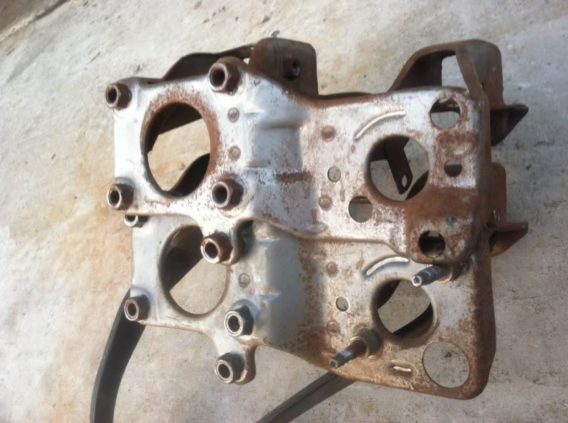

Day One! It doesn't really matter the order you do this in, I just chose to start with the pedals and the clutch master cylinder because those were readily avaliable to me at the time. I had the pedals and thanks to Autozone rewards, I had credit on my card so I was able to pick up a free clutch master cylinder. It normally retails for $18 with no core charger.
After doing some research I discovered that the auto and manual pedal setup were near identical so I started with using the auto pedal bracket as a template to drill the holes for my clutch master cylinder. Looking at the bracket, ideally you would drill a 1.5" hole for the plunger and two ~1/4" holes for the bolts. Since I only had a 1 3/8" drill bit, I went with that and it worked!
Here are the two pedal brackets, automatic on top and manual on the bottom.

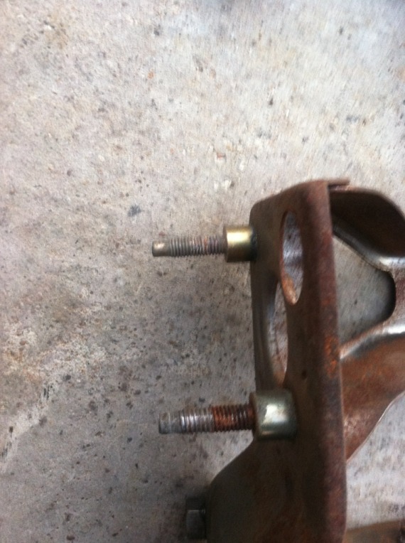

Here's a close up on the bolts that the master cylinder bolt up to. When you drill the holes in the firewall, you want the threaded bolt to go through, but not that spacer.

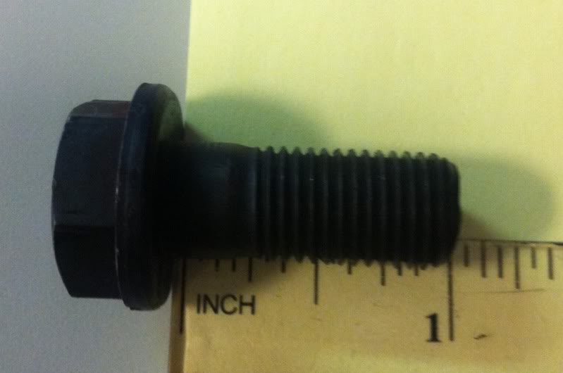

After going to the junkyard the other day and deciding that it wasn't worth pulling the transmission and transfer case to get to the flywheel and pressure plate bolts, I went to the dealership and ordered new flywheel and pressure plate bolts. I ordered six Flywheel bolts (Toyota PN 90913-01011) and six pressure plate bolts (Toyota PN 90119-08079) and it came out to $35. After reading everywhere that the automatic flex plate bolts are different from flywheel bolts, to my dismay they are the exact same bolt. I'm sure my parts guy ordered the right ones since I was talking to him about the swap. Maybe 22rte flex plate bolts are longer than 22re flex plate bolts? Oh well, I guess that's why I made this thread, to give a comprehensive write-up!
Here's a picture of the flywheel bolt. It's just under 1", so if that's how long yours are you're fine!
Hopefully my parts guy will let me return these and get my $30 back since they were special order. *Fingers crossed*

I told you! They are the same bolt. I literally just did this about 2 weeks ago. And I had a turbo automatic. Went to a turbo 5speed.

My mistake! You made it sound like you just decided to re-use your automatic bolts, I didn't know that they were the exact same bolts!

My 92 auto had shorter bolt and the manual from my other 92 had longer and the ones I got from Toy were the longer and they had the loctite on them.

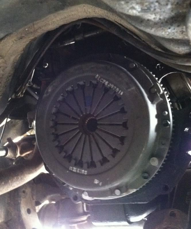

Alright, I got a lot done today! I first installed my turbo clutch kit and flywheel. As everyone reminded me, I didn't forget to install the pilot bearing! Although I've done many of these swaps before, it's an easy item to forget. It also helps that I bought a clutch kit that included one, so you stop and think to yourself, "What's this bearing in the box for?"

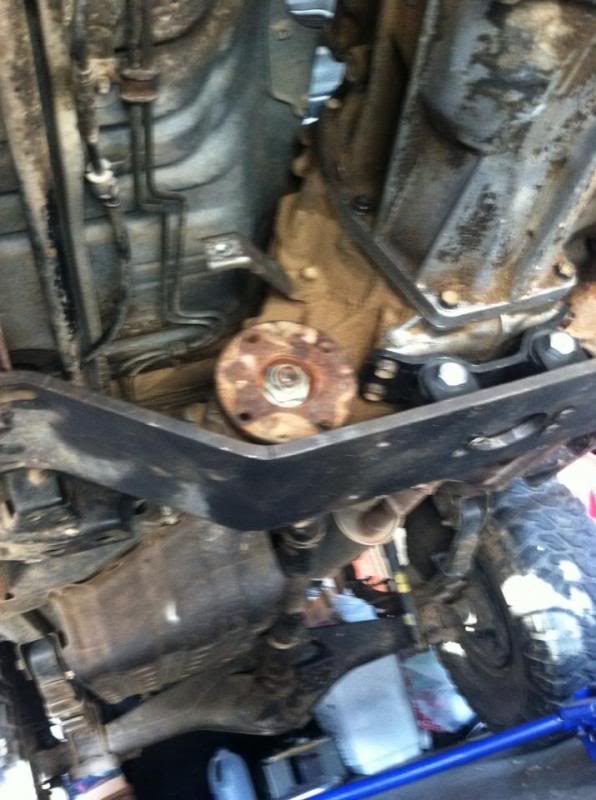

After cutting the hole in the transmission tunnel, I bolted up the transmission and t-case to the engine. From there I tried bolting up my Budbuilt crossmember and rear drive shaft. Luckily, both fit just fine! Out of curiosity I took rough measurements of both transmissions and it appears as if the manual transmission is only 1.5" shorter than the automatic (38.5" vs 40"). That was a huge relief!
Here's a shot of how I left it, with the 4xInnovations mount and Budbuilt skidplate in place!
For all things that worked out, I had a few small hiccups. While bolting in my transmission/transfer case, I noticed that my transfer case didn't have a 4WD sensor. I'll have to go to the junkyard and see if I can find one of those.
