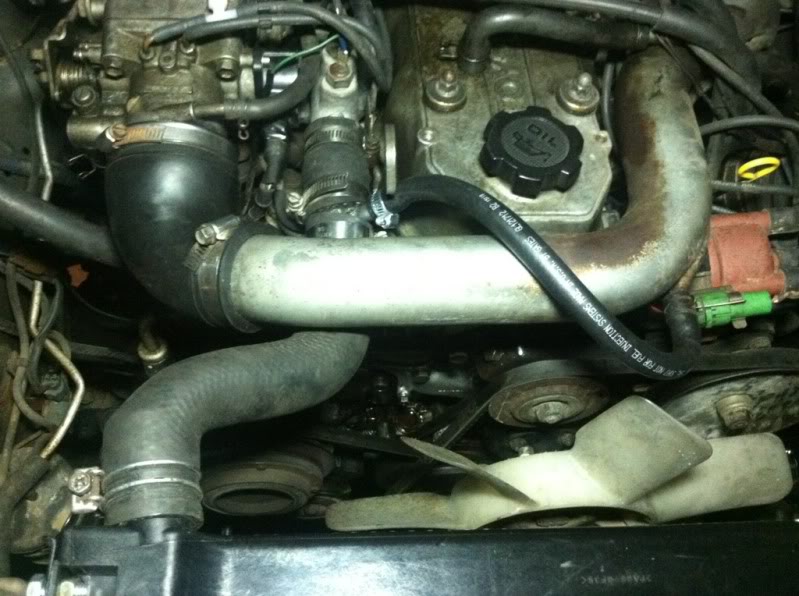

pic of your current radiator? might be the issue, but since you have the turbo, that throws in a few more variables

There is a pic on the first page of this build showing the backside of the radiator. It's still in the truck and I can't remove it since my other car is still in paint but from when it was out a few months ago it looked fine to me. All the fins looked good, but the truck did sit for 13 years, probably with coolant in the radiator.

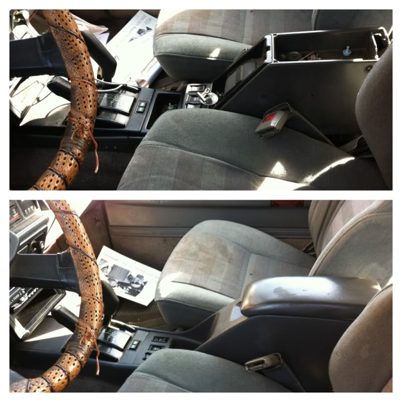

Ever since I bought this 4runner, my armrest has been broken. Instead of trying to track down another brittle first generation 4runner arm rest and center console I decided to do the same modification I did to my last 4runner and add a second generation armrest and center console. Here's a shot of my old console on top and the new one on the bottom
The only modification needed was to use a rat tail file and open up some of the screw holes a bit, but other than that it's a direct bolt in and all the switches drop right in. It was actually easier than on my old stick shift 4runner since I didn't have to do any trimming for a transfer case shifter.

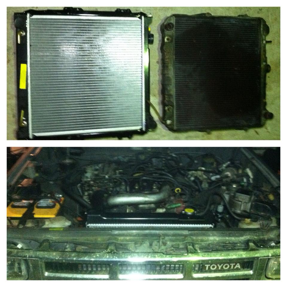

While playing with my boost controller I noticed I had a small pinhole leak in my radiator. I pulled the radiator, took it to a local radiator shop and the guy pointed out a few pinhole leaks on the top tank of my radiator. So that's why my truck overheats on grades! Turns out it's a common problem with these turbo 4runner and they even stocked upper tanks for these radiators. After talking with him for a few minutes he advised me that it would be cheaper if I were to just go out and buy a new radiator with a lifetime warranty elsewhere. Now that's great customer service! Giving an honest opinion even if it means turning away business!
I thought about order a radiator from Radiatorbarn.com but it seems like there prices have skyrocket over the last year or two. I decided to go with a V6 radiator from Autozone because if I ever break it on the trail, I'll probably be able to find an autozone location within 100 miles!
Here's a picture of my old radiator vs my new radiator and the radiator bolted into my 4runner.

Bolting it in was the easy part! It sat a bit higher but still cleared my hood!

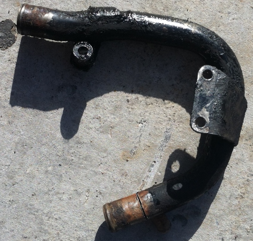

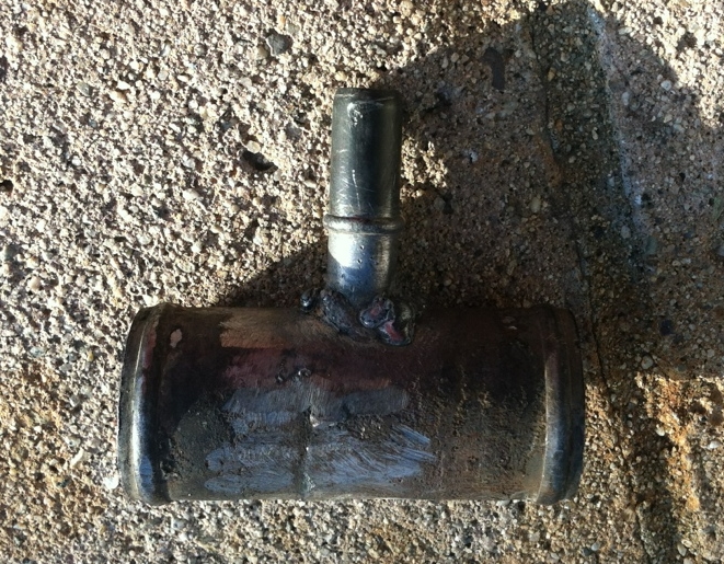

One issue with the non-turbo radiator is that it doesn't have a turbo coolant feed port, so I would have to make my own. I started by measuring the coolant ports on the radiator and thermostat housing and found that they were 1 3/8" diameter. After searching the shop to not find any steel tubing that size I had an epiphany! Why not use an extra hard coolant line that runs on the driver side of all 22re blocks! I ran over to my parts bin, found one and thanks to a magnet I discovered that was in fact steel! For those of you not familiar with the tubing, here's a picture of what I'm talking about.

I cut off the ends, welded them together and welded on a steel nipple I found in my garage.
Not the greatest welds, but they have yet to leak!

Although everything is up and running I still need to figure out what to do about my radiator shroud. My 22re shroud doesn't line up right or cover my whole radiator. I need to go find a v6 radiator shroud and see if it'll line up with the fan placement on a 22re. Has anyone done this before and can chime in?
The radiator set me back $140 and miscellaneous rubber tubing from Kragen was another $10. So I'm $150 in on this radiator, bringing my total cost of the 4runner up to $4352!
