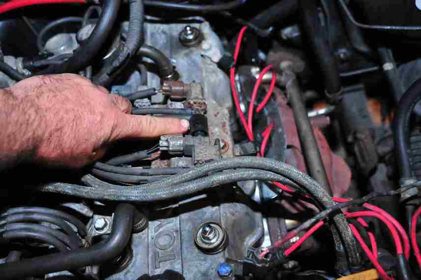

Thanks to all for the advice! It ended up being one of the Vacuum Switching Valves, or more specifically the filter (I guess that's what it is) on the end of it. Take the filter off the noise stops, barely touch it to the VSV and it starts making the noise again. I don't know how necessary the filters are. This one VSV out of the three is the only one with a filter.

In the pic I'm pointing to the filter on the VSV that is making the noise.
