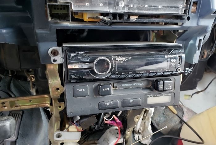

So my '93 truck was stolen and stripped a while back and it's been a long recovery. At least I got it back to be able to fix up again, lol. So one of the frustrating things they stole along with the stereo was the actual brackets. So I bought what seem to be the brackets, and from anything I'm able to find online, are the brackets for this truck. But they can't be, as they are about an inch too low, and set about 3/4in back into the recess.

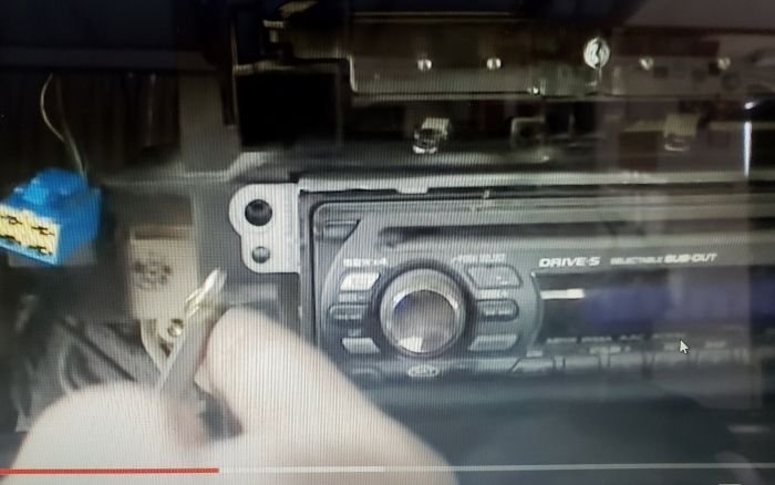

I've looked everywhere to find an alternative, and can't seem to find anything. I'm including a screenshot of a video showing how these brackets fit up right into the top of the space on another truck. I notice that the top of the opening on mine comes out at an angle. Anybody have any insight for me?

@rattlecanpaint unfortunately not. My first inclination was that I'd assembled it wrong, but It seems that's the only way these fit together. The as far as the difference in vehicle models, the screenshot is from this video
of a '94 4Runner, mine is a '93 Pickup. As far as I can tell from searching out this part, and looking at diagrams etc. that's what I should be seeing. But I've yet to see anything that looks like my dash setup, or a bracket that would bring the stereo up and into place.

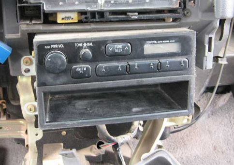

It should look like this:

comparing Paul22RE's picture with Jeffe78's, it looks like the bracket is attached to the headunit too low on the headunit. I replaced my factory deck with a double-height after-market whiz-bang unit, and while I don't have any photos I recall that there were several places on the unit into which to put the screws in order to adjust the height.
If that doesn't work, it's possible that your replacement head-unit has "non-standard" (or, at least, not the same as a 27-year old Toyota) bolt spacings, and you need to use the brackets designed for that unit.

it might help if the OP would show a side-view picture of the dismounted stereo unit....

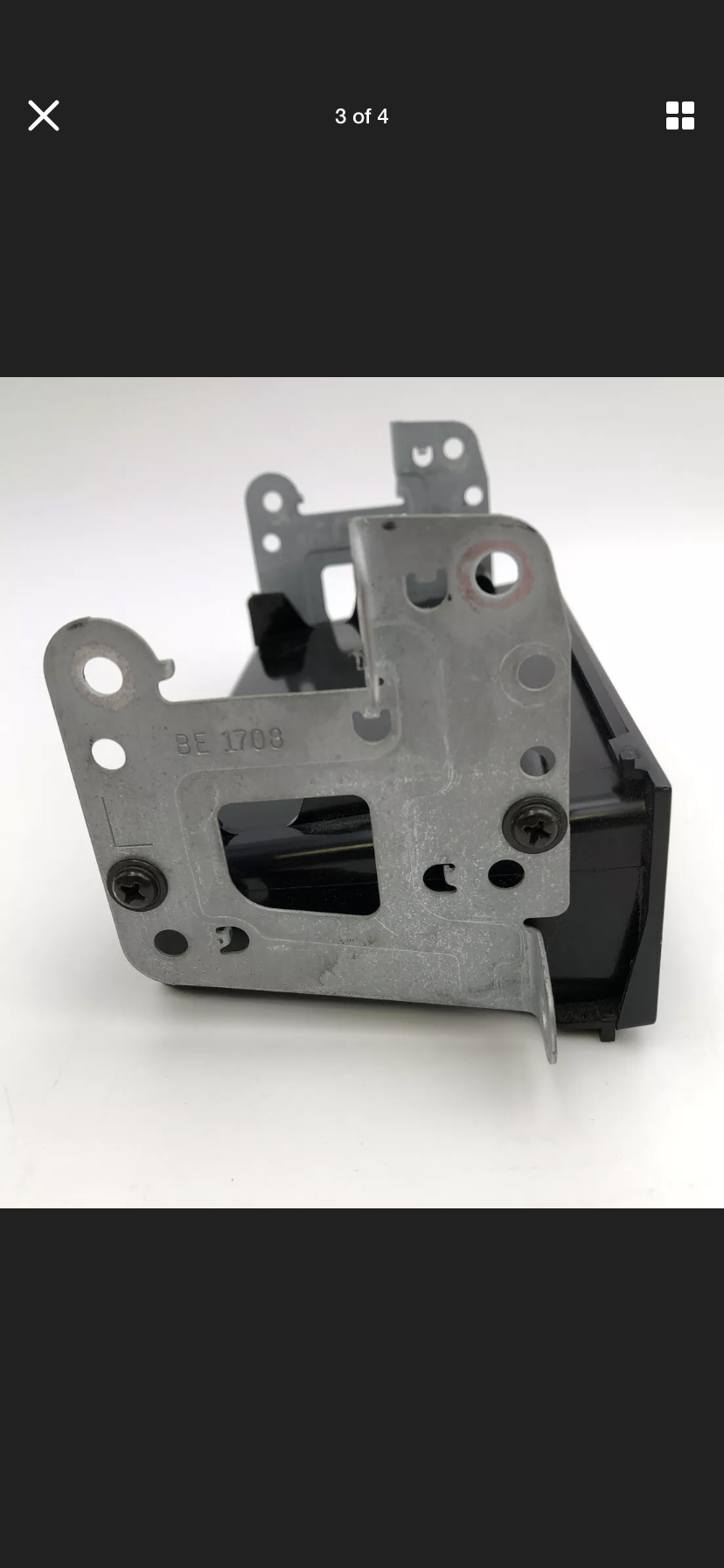

I am currently having the same exact issue, that is a 4Runner bracket and we have the “hilux” which doesn’t have the small extension where the bottom mounting portion bolts to.
This is the bracket you need
