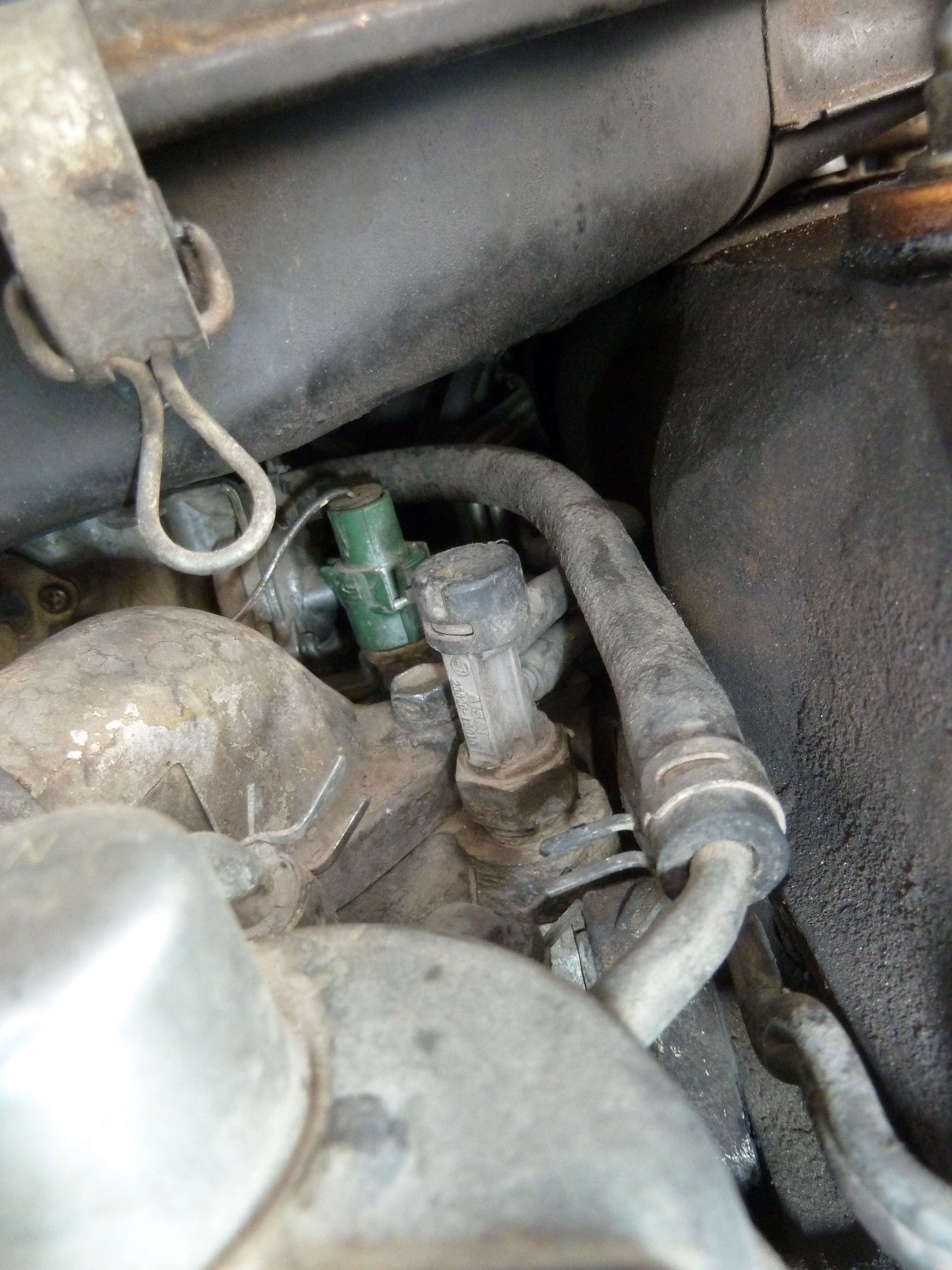

Let's see if I can get this to work, that is attaching a picture: Here is the fuel line from the fuel pump to the Carburetor
grey

I can see the pic.....that line needs to be shielded from heat and the problem will probably go away.
Why would this be a problem now on this engine in a different body? I ran this engine in my 85 two wheel drive pickup with no problem from November 2001 when I bought it until the little truck was totaled with a bent frame in May 2013.
Just curious why it would have problems now when it never had them before? The only difference is the engine is in a 1987 4X4 instead of the 1985 2X4 the engine came out of. I had driven that little truck through Blythe in June and July with no problems...
grey

Too many variables to say .......rebuilt engine with untold number of rebuilt parts.....transferred over to a different chassis....

could even be a hot spot anywhere's all the way back to the gas tank......not privy to your exhaust routing and fuel lines. In any event, braided fiberglass is a solution.
