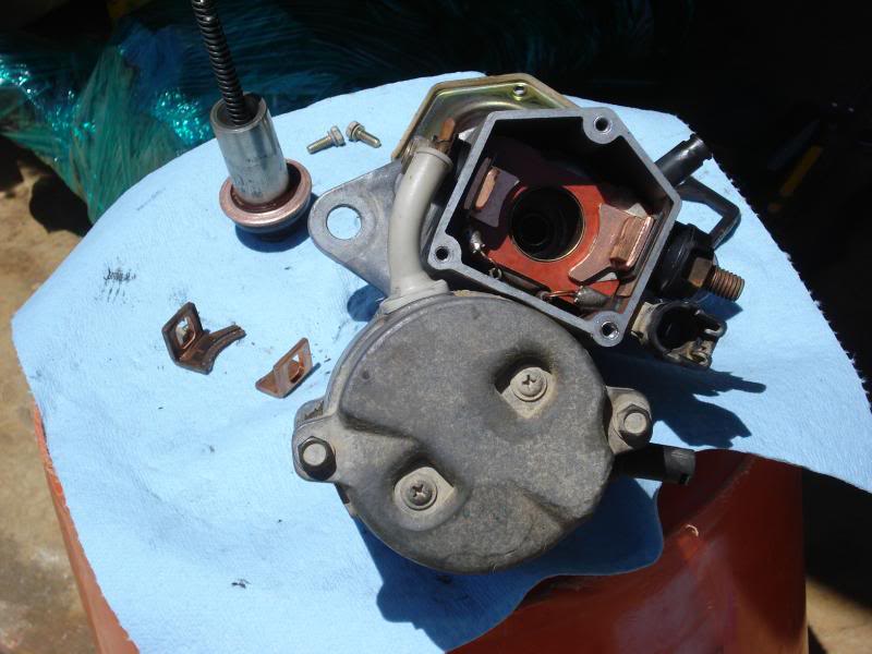

My 94 pickup starts like a champ now, after using 4Crawler's A and C points in the solenoid. Take the tire off to get at the thing, it's much easier. And, remove the steering stabilizer to pull the unit out. If you have enough lift, you may be able to remove the points without taking the starter out.
