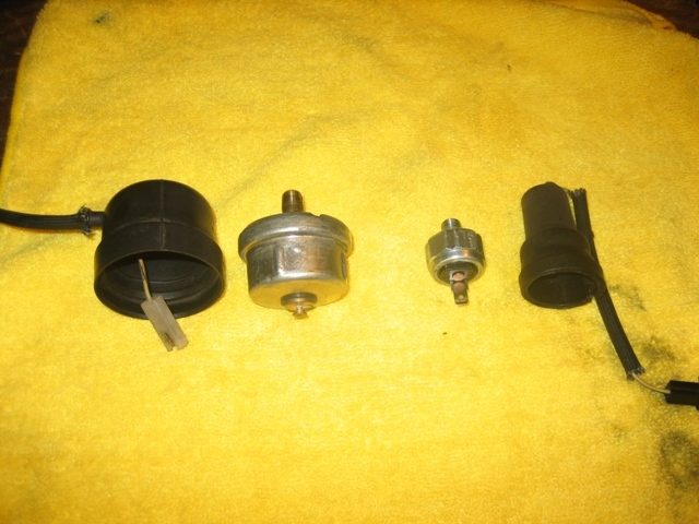

While I was replacing the starter, I inadvertently pulled off the dust cap of the oil pressure sensor. Inside there is a connector, but I couldn't see what it connected to. I didn't even know what it was until I drove the truck and noticed my oil pressure gauge flatlining so it must be the gauge sender. I don't think i broke anything off, but am not seeing what the wire connects to under the dust cap.
edit: found this pic which looks just like what I have under the dust cap. Where does the connector go?

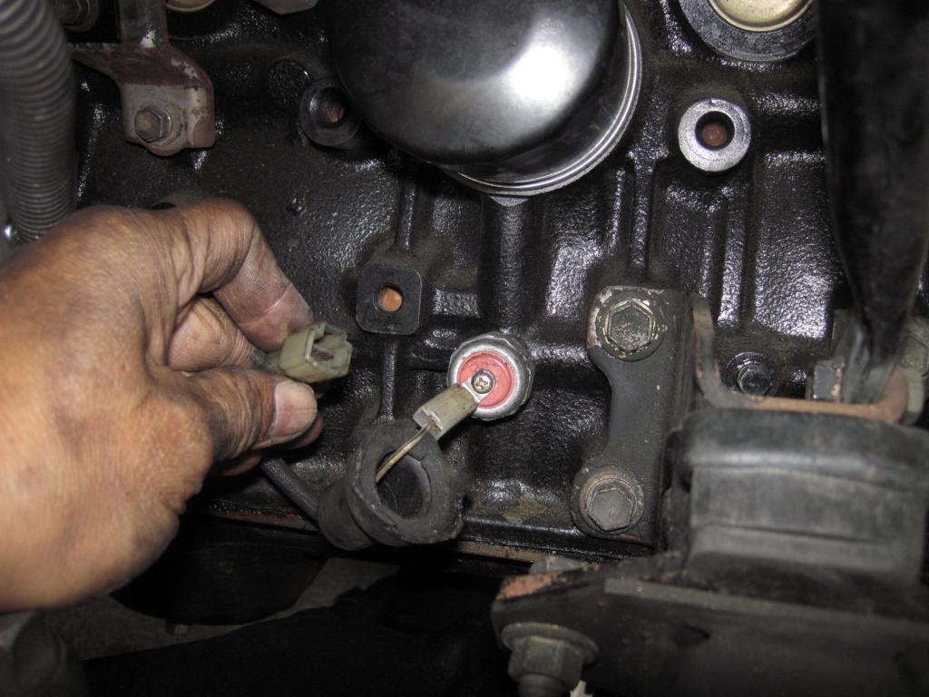

On 1986 22RE, wire is screwed into sender. Inspect connectorS, wire and contact at screw.

So on close inspection, there is no terminal for a standard connection, but the button/nose of the sending unit is the actual terminal and there is a groove cut on the side of the wire connector for a sideways connection.
Found a pic that gives a good visual (left sensor)

Why bother with pictures? Why not get in there, look at what you actually have, look at the actual connector, see what's keeping it from making contact with the sensor, inspect what's wrong with connectors on both ends of the wire, inspect what's wrong with the sender contacts, do continuity check of that wire.... etc. ?
Old Nov 15, 2014 | 03:31 PM
Brendan's Avatar
Joined: Dec 2003
Posts: 2,226
From: Vancouver, BC
I did. The picture is to show how they go back together. At the time that I first pulled the boot off by accident, I didn't know that it was the oil pressure sensor so I just assumed that it was another one of those wires that don't go anywhere. My truck is a base model so I have a few of those here and there.
