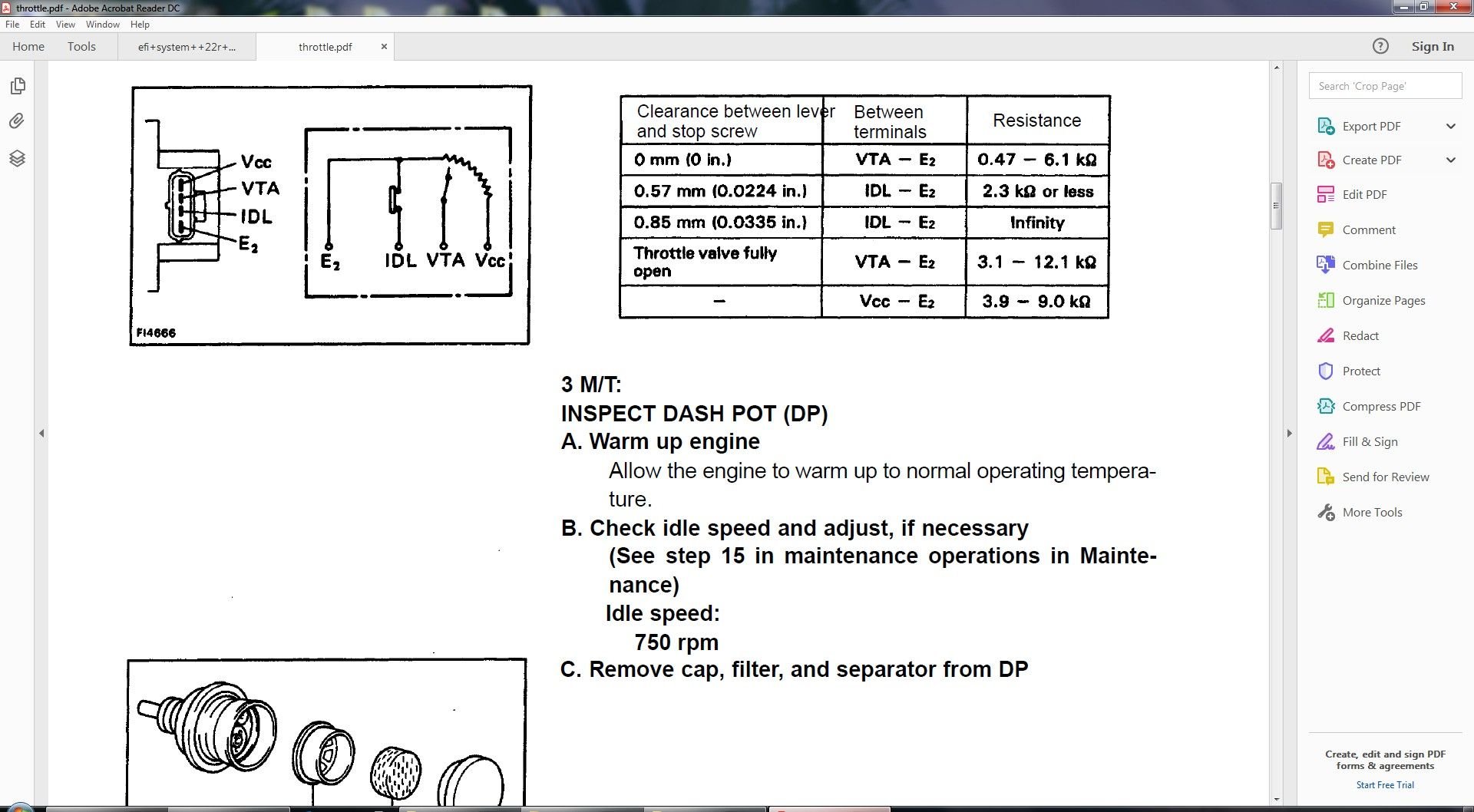

TPS Readings
You don't have to take the throttle body off the intake to check the alignment. You can do it "in situ", or in place. Just need to pull the plug, and have a feeler gauge to insert into the the throttle stop screw to set the proper amount of "open" for the throttle body. What and how to measure and adjust is all in the FSM. Do you have a copy of the FSM? I strongly recommend getting one, even an electronic version. VERY handy to have.
Look here: 1990 4Runner repair manual and schematics
Just click the Download button. You will get the two manuals as a PDF downloaded to your HD.
You can print pages you might want to take out as reference while working on the truck
Make sure the idle, when warmed up all the way, ALL the way warm, is at 750 before you try setting the timing. According to the FSM, it should be 5° BTDC, with the jumper in. It's entirely possible the distributor is off by a tooth one way or the other, which would cause a lot of the troubles you're seeing.
All the above images are from the 1990 FSM I just downloaded
I hope something helps
Pat

Setting the TPS is more difficult on the 3VZE than the 22re, because the TPS connector points the "wrong" way to get your multimeter in there. (lastcall has the 3VZE). But here's the FSM for it:
http://web.archive.org/web/201108151...93throttle.pdf
Don't get too worked up about the exact resistances and the feeler gauges. All you're trying to do is get the IDL switch to open when the throttle opens. All the details are just to "define" what "open" means.
What they don't mention in the FSM but is pretty important is to check the resistance while you sweep the throttle from closed to open and back. The exact resistance isn't important, but you want a fairly smooth change. If you have opens or shorts the ECM won't know what to make of it.
