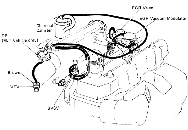

That really does sound like a vacuum leak. The engine and brake booster shere vacuum, so any leak will affect drivability. I would start by checking a vacuum diagram to find out where those plugged lines are supposed to go, then spray starting fluid around all of the vacuum lines and manifold. When you hear the idle change you have found your leak. Good luck.

This is the best representation that I have. Even my fsm doesn't have this. But where the egr valve and the modulator are, i only have 3 lines instead of four. And i had pictures of the thing on my phone, but ugh, ill have to check tomorrow. But i do think i have a line coming somewhere from the passenger side from some unknown area, so i plugged it. This diagram is the closest i can get to what i have.

ok, sorry. picture challenged here.
