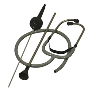

For the bearing, the only thing I can think of is using a mechanic's stethoscope. The version that is hollow and can channel the noise to the ears. There's two versions.
http://www.amazon.com/Lisle-52750-St...7s+stethescope
With the stethoscope you can move the cone back and forth over different areas to see which makes the most noise. However, because the clutch overlaps the nose of the compressor, it still may not work.
