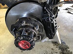

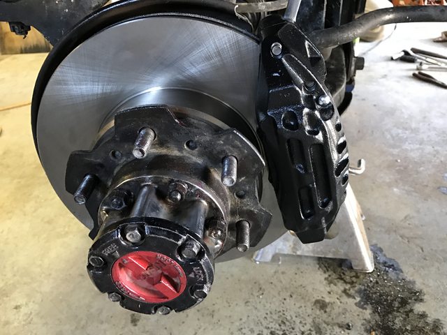

So Update:
1. I cut my LSPV arm and used an adjustable turnbuckle to set the length and secured it to the arm pretty well with a few zipties... ghetto i know but it actually works. Thanks 4crawler. (minus the zip ties)
2. I was seriously so sick of the brakes on my truck that I decided to go to napa, buy 1994 T-100 V6 Calipers for both sides, Ceramic Brake pads, T-100 Rotors, and My buddy had a pristine Dual diaphragm brake booster/ 1 inch bore Master Cylinder from a 1994 v6 4Runner.
I removed all of the 4cyl garbage, removed my MC and booster and smashed it with a ball peen a few times. Im pretty sure they were junk anyways, there was a lot of brake fluid between the MC and booster. Then I installed the booster and MC and bled the MC. I saved the calipers because the core on them was $65 bucks each, so I couldnt launch them into orbit. Installed the new Rotors, trimmed some of the back plate with an angle grinder, bolted up the calipers and installed the pads. I then bled all 4 corners and adjusted the rears AGAIN... then gave it a test drive.
The first press of the brake almost sent me through the windshield as i reversed out of the driveway. I was not used to this ridiculous of braking power, I Sh you not... The upgrade in braking is so incredibly great it is absolutely ridiculous. This should be a MUST DO upgrade. It is time consuming, and every time I said "I" up there ^ I meant myself and a friend darnell who is the man. I have never taken the hubs apart and he seemed like he was born inside of those things. He knew em inside and out... thanks man
The braking now is so effortless for a ridiculous amount of stopping power. My LSPV is bad, it makes a metal to metal "shink" noise like two swords scraping against each other when you press the brake down hard. You can feel it on the brake line that leaves the LSPV and goes to the rear brake drums. Im going to put a willwood or somthing in there next and hopefully get rid of the load sensing part. Thanks everyone for following through my high blood pressure stressful pull my hair out saga of brakes... Feel free to ask any questions.
Dont ya love brand new shiny parts? too bad they dont stay looking like that all of the time.... Almost makes me want to put some 24 inch american force wheels on my 4runner so I can show off my bling bling brakes

Also, it seems that since i have done this swap, even if i move the arm of my LSPV all the way up my fronts still lock up before the rears. The front brakes are just a lot stronger now i guess...

An alteration in the rotor and/or caliper piston diameter alone can make a big difference in brake bias. ....not to mention the affects the new MC may have, different pads, etc. So yeah, the fronts are doing a lot more of the work now.

Yeah i can see what they mean in the article. I do not have a further stopping distance though, the truck stops on a dime. I do still need to install a manual proportioning valve though. Im almost certain that my stock lspv is not properly functioning.
