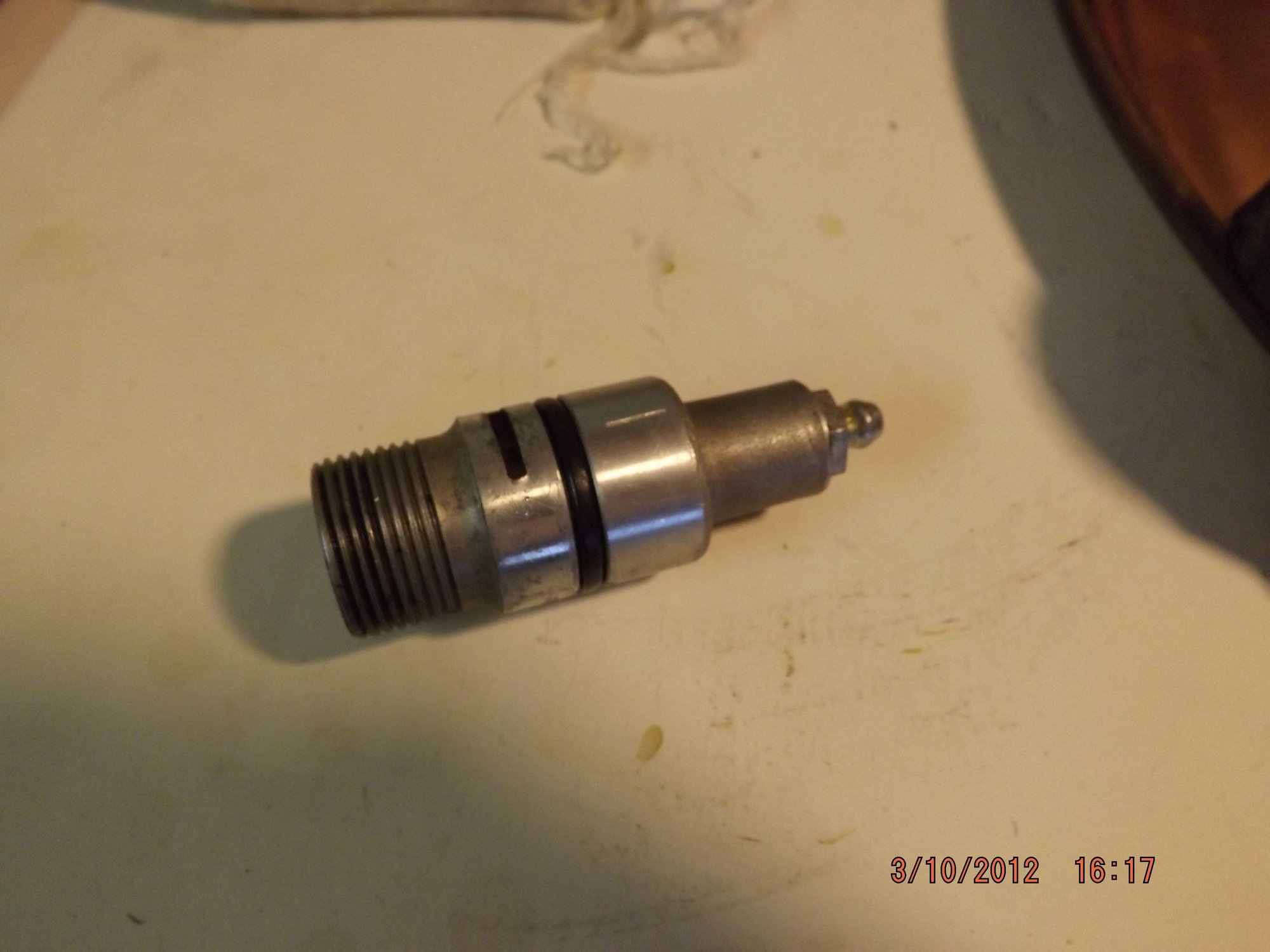

Toyota factory cables have a flange at the head that prohibits the removal of the cable core.
I don't think the core can be removed from the top either, because of the core end shape at the bottom.
I made a greasing adaptor by removing the guts from a speedo drive and tapping the housing to accept a grease zerk:::
Gotta be careful not to over-grease, because a speedo head full of goo is a Bad thing.
