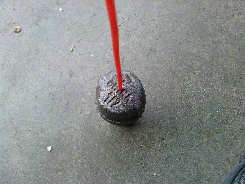

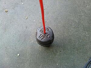

My 1987 4Runner with 345,000 miles had a bouncy speedometer needle. During the cold mornings, the bouncing was way more violent and a horrible noise came from in the dash. Here's how to make a tool which allows for easy cleaning/greasing with any aerosol can.
It just so happens that 1/2" pipe from the hardware store screws perfectly into the transmission side of the speedometer cable.
You'll need a short piece of 1/2" pipe from your hardware store, a 1/2" cap to fit it, teflon tape, and an assortment of drill bits.
Tape the short pipe, screw the pipe and cap together, then drill the cap so the little red spray tube from an aerosol can fits snug. Mine fit in tight, didn't leak and didn't have to be glued or sealed.
Once this is done, pull the gauge cluster and have a helper hold a rag over the end of the speedo cable to collect the mess and goop that will come out. Run some brake cleaner through to clear out the old dried up grease. Either let the cable sit or blow compressed air through to dry it out. Next spray your lube of choice through until it comes out the other end. I chose white lithium grease because the can specifically said it can be used on speedometer cables.
Button it all together and enjoy your smooth and quiet speedometer!

I needed to grease my cable and this appears to have worked for me. The teflon tape is a must since the pipe threads are a little different than the cable end threads. I also used PVC pipe since it was much easier to drill the cap. Also I used the shortest nipple I could find. It took quite a few tries to get the grease to flow out the other end. It would probably be best to have someone help. The cable end at the speedometer needs to be bent down a little by someone while spraying since it blocks the flow of the grease. A lot of brown goo came out at first and I kept spraying until it finally came out white.
The hardest part is just disconnecting the cable from the speedometer. I ended up removing the entire cluster since I could not get my hand in behind it from the bottom of the dash.
