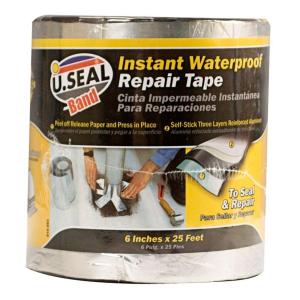

Dynomat is made for just what you are trying to do but its kinda $$. However you can head to your local hardware store and pick up an adheasive roofing repair roll. Its about the width of a double wide roll of duct tape. Pull the interior and roll the roof patch material out sticking it to the floor, door interiors, back of cab etc. Cut out around all the mounting holes and replace the interior. It works as good as dyno mat and will cost you less than half the price.
Just what I was going to suggest. You can get it at Home Depot or Lowes. Great stuff and easy to install. I've done the drivers door and the rear cab wall in my daughter's truck so far and it does make a difference. I plan on doing more, like the passenger door and probably under the carpeting and possibly even the roof to stop rattles and reduce road noise some. The Drivers door closes with a good, solid thunk now instead of the normal Toyota tinny sound. And at $16 or so a roll, you can't beat it.
