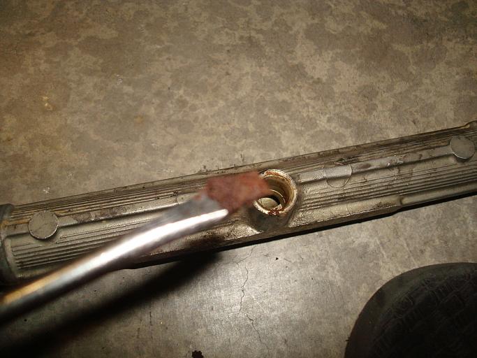

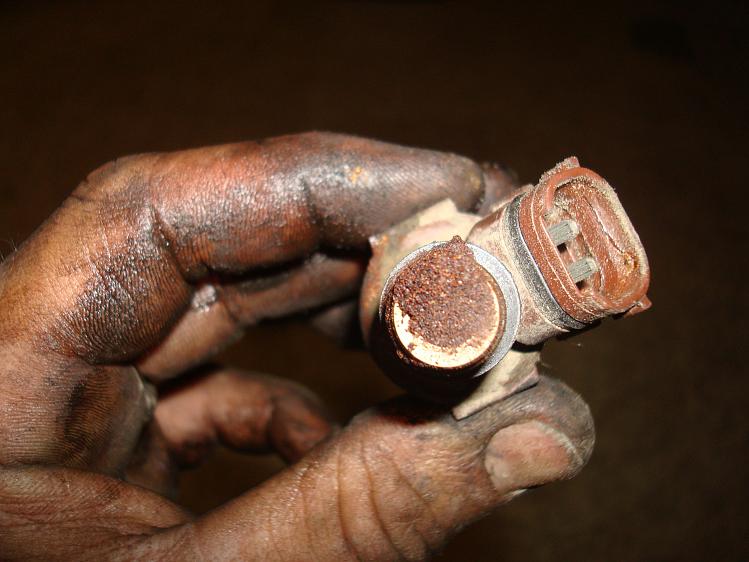

i found the problem, will post pictures tomorrow, i had a feeling it was the injector(s). #4,#3 were clogged to the max with dirt you will see in the pic tomorrow, i guess thats what happens when you got a fuel filter from 1992 the day the truck was born....I bought the truck one month ago, it was sitting for a year so i did all the basic maintenance. so it went trough its first full tank of gas pretty much today and thats when all this happened. so i knock on wood that this takes care of it. oh ya maybe some suggestions on things to do while i got everything apart........

Ok here is the pictures of my clogged up injectors/fuel rail, #3-#4 were fully clogged but i still cleaned them all, runs like new.....

Wow!!! Those are yucky...
