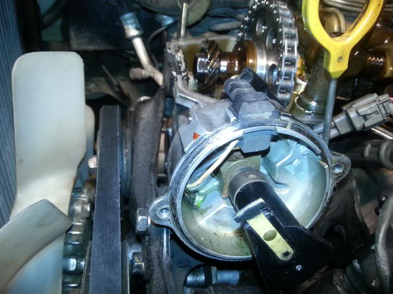

this is where it is at

Old Sep 17, 2013 | 07:26 PM
  #29
Kiroshu's Avatar
Joined: Oct 2007
Posts: 2,747
From: NC
Is the crank shaft at TDC along with the camshaft...?
Crankshaft at TDC #1 cyldiner.
"Notch" on crank pulley/vibration damper pointing at 0*...?
Cam and crank must match TDC together or the engine will not operate properly.
It seems like your distributor is still installed incorrectly to the engine being at true TDC.
Seems like you have the distributor installed at TDC for the camshaft when the crank shaft is not at TDC. (Which I believe would be #1 cyl's exhaust stroke.)
Line them up together and re-install distributor.
