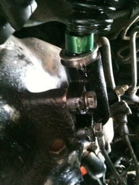

Pictures and more information about Slave cylinder
Ok here are pictures of what's going on.
Information that may be important.
I have the clutch fork positioned with the pivot ball spring clipped in position on the the round depression. I believe it is properly positioned. -> snobdds
Bearings are all brand new- eric924run
The clutch fork is clipped with the two metal clips but nothing else to the release bearing assembly. -> Blake.nemitz
The parts are not OEM, they are just from carquest. Side by side with old cylinder they seem to be the same in all dimensions.
I love the idea of making a new cylinder interior from round stock but am not equipped to do so. ->blake.nemitz
Thanks again everyone, I'm feeling a breakthrough on this lovely beast soon . . . .
Attached Thumbnails Slave Cylinder Over Extends - What's Wrong?-img_0217s.jpg   Slave Cylinder Over Extends - What's Wrong?-img_0223s.jpg   Slave Cylinder Over Extends - What's Wrong?-img_0216s.jpg

seems the fork is out of the pivot and went to one side
Old Dec 22, 2011 | 02:33 PM
snobdds's Avatar
Joined: Nov 2008
Posts: 2,306
Likes: 8
From: Cheyenne, Wyoming
Yep. In the 1st photo you can see the fork is about an inch past where the "old boot mark" is. There is a slight color difference where there is rust and no rust.

So this is a drop the tranny again kind of thing huh? Damn. Thanks everybody. .

Might try repositioning the fork without dropping the tranny. I don't remember if our clutch forks can be repositioned like that or not, but it's worth a shot.

Granted, I'm looking a pictures, so hard to judge scale, but it looks to me like the fork is too long and/or protruding too far out for the slave piston land squarely on the tip. The tip should only extend about an 1" from the bellhousing boot.

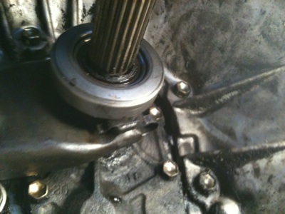

Fixed the Clutch, found out 1st and 2nd don't work.
Thanks for all the help and advice, you all were right who said the clutch fork wasn't installed correctly. I found a picture of the fork here in the forums and (after dropping the tranny again) put the thing on properly before reinstalling the transmission.

The picture is of properly installed clutch fork clips in my broken transmission.
Thanks again for all of your help!
