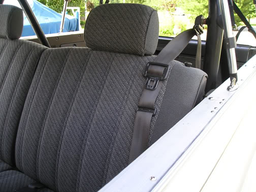

4runnerx3's Avatar
Joined: Jul 2006
Posts: 922
Likes: 6
From: North Carolina
Front seat belts bolt right to the roll bar. The front floor bolt goes in the side panel near the floor. Use the same screws in the same places and use the collar spacer on the roll bar where the bikini support bar shares the mount.
