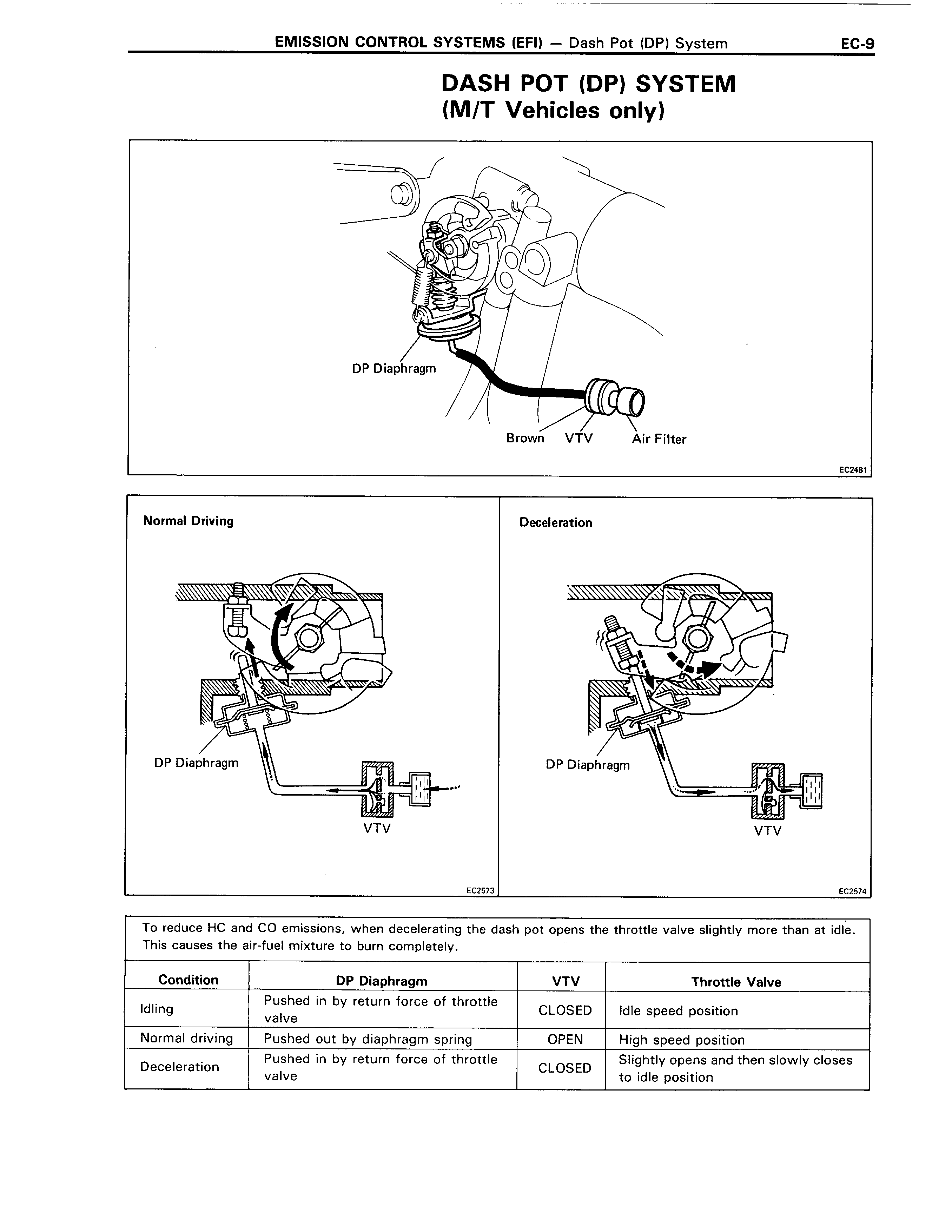

Looks good Phil. I was wondering how this all went for you. It's on my list!
The hose you are questioning appears to be connected to the dash pot for the throttle body. A "VTV" is suppose to be at the end of the hose. The VTV is basically a one way valve (#23281) with a small filter (#17810A) on the inlet. I'm at work and don't have my camera. I have attached a parts breakdown for this for your reference.

Thanks Mark - that's the ticket all right!
Please excuse my ignorance but what do the dash pot and VTV do? I'll spend some time looking it up online too, but I see them referenced a lot on other threads and was curious.
Does not having a VTV cause any problems? Does it just "hang there" or does it mount to the throttle body?
I'm ordering some OEM parts soon anyway, and may just add this to the list....

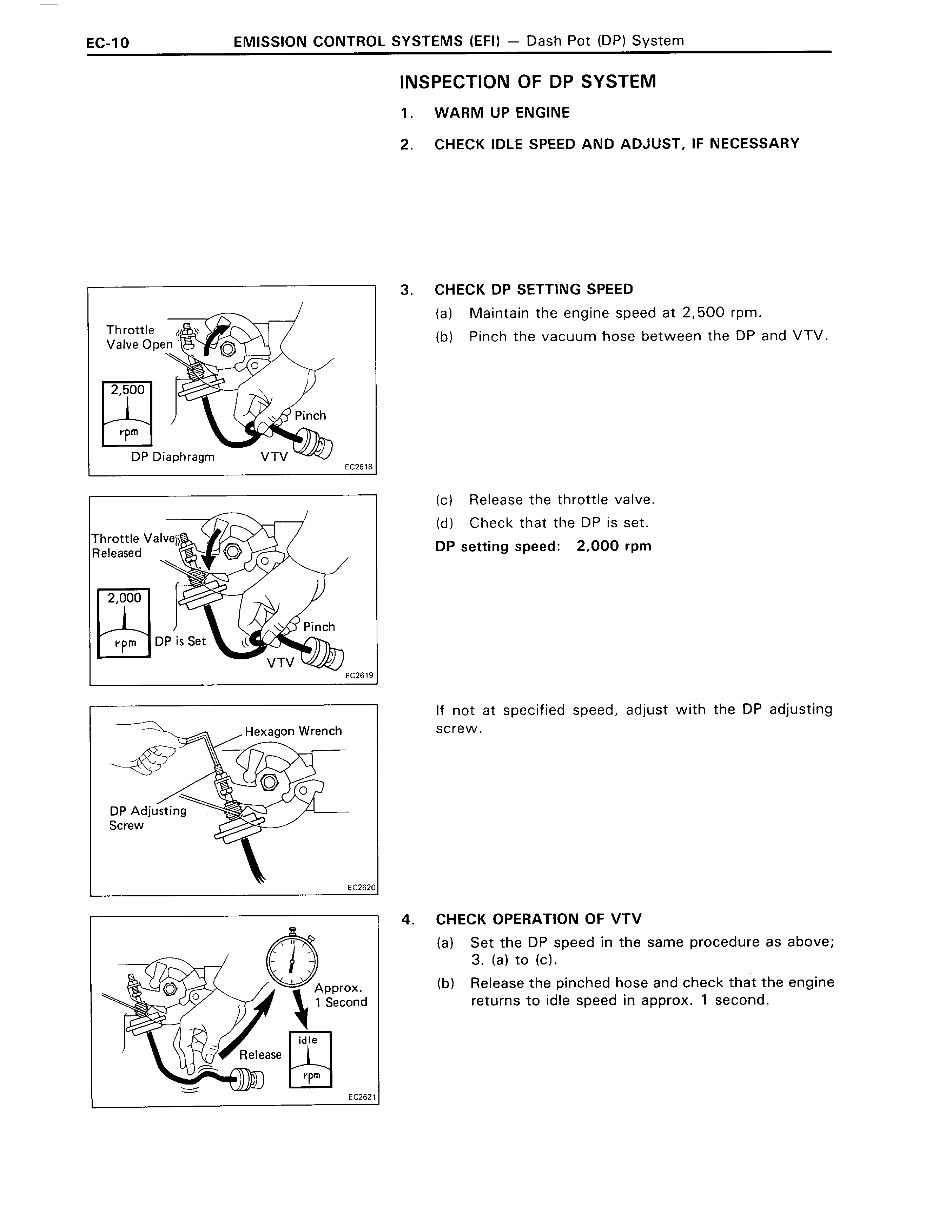

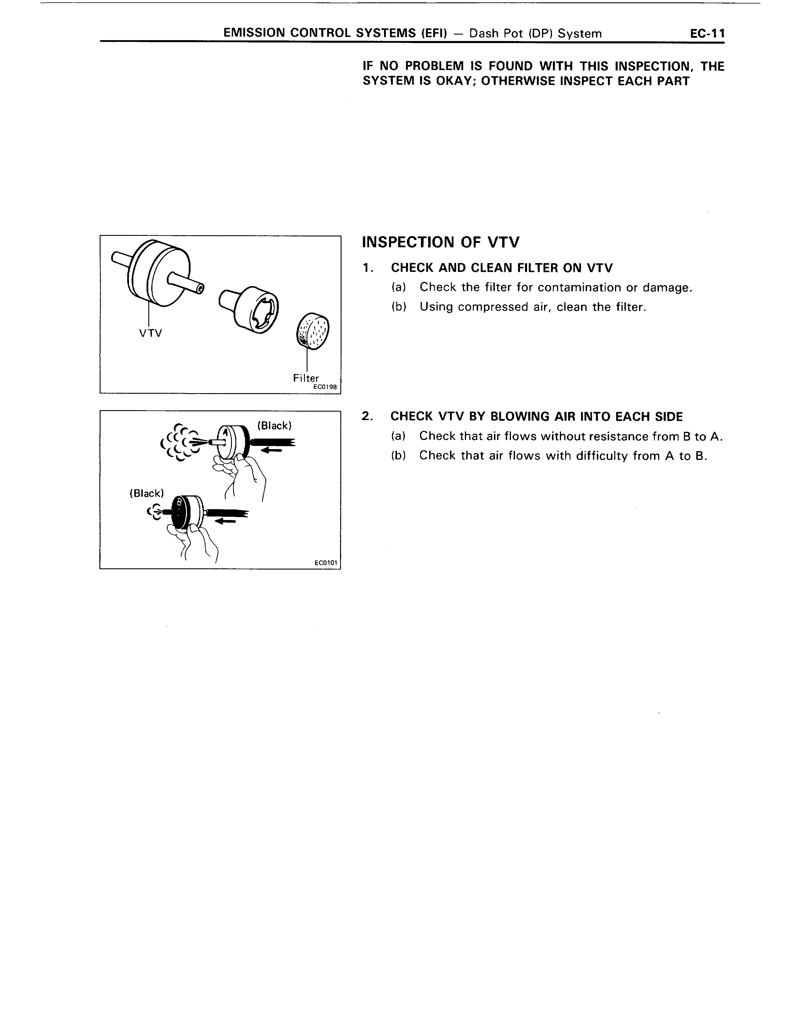

Check on the section in the FSM.

Thanks Mark for the pics of the FSM.
So, looks like I have no VTV at alll....hmmmm....
And it looks like the VTV is supposed to just "hang there" under the throttle body/DP area?
Here's how I understand the test in the FSM (please correct me if I'm wrong):
1) Get the idel to 2500 and hold it
2) Pinch the hose to the VTV while idling at 2500
3) release the trottle while still pinching the VTV hose
If the throttle drops to 2,000 and holds while still pinching the hose, it's working. if it does not drop that low, or drops lower, then the DP screw requires adjustment and/or the VTV needs cleaning.
Is that correct?

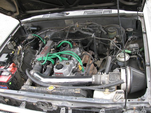

I got my green hoses in!

Looks great!
Cool looking intake too
for my questions about testing the VTV - anyone know how?

The dashpot just has a rubber diaphragm inside of it and the VTV is a little valve on the end of the hose. When you open the throttle, the dashpot diaphragm moves and sucks air in thru the valve. When you let off the throttle, the valve keeps the air from rushing out of the dashpot and therefore your idle stays around 2000 rpms. The valve slowly lets the air bleed out and in a few seconds your idle drops down to normal. Obviously without that valve your dashpot really isn't doing much. The little plunger that the set screw contacts on my dashpot was getting cockeyed and jammed sometimes which was holding my idle up at very high levels. I removed the set screw and my issue went away.
So to try and answer your question, by pinching the line you are checking that the dashpot is holding air and that the set screw is properly adjusted to keep your idle at 2000. To test the valve (if you had one) you can blow through it one way and then see that it's difficult the other way.
