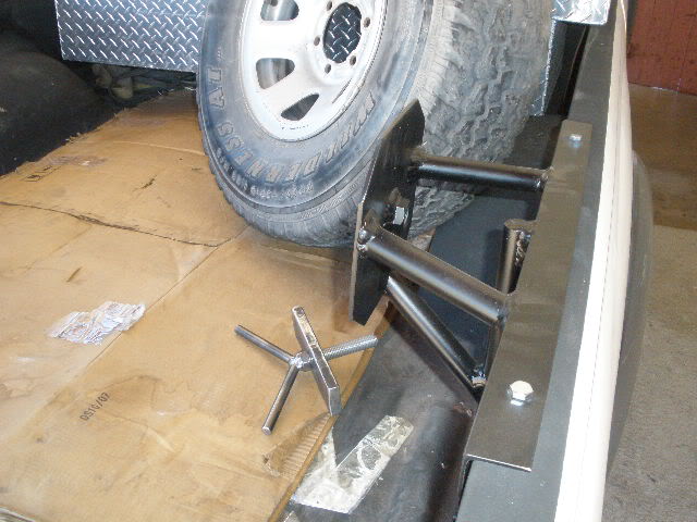

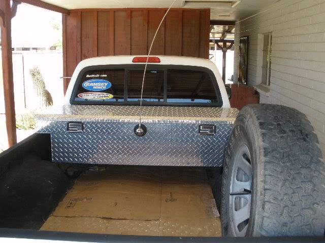

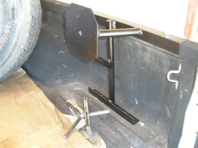

I have a tool box so I stuck it here....

^I dig that. It's exactly how I was going to mount my spare once i finally get around to picking up a matching 5th wheel - only mine will be on the driver's side so it's not in the way when I look over my shoulder. Passenger side will get a similar holder to carry hi-lift and shovel.

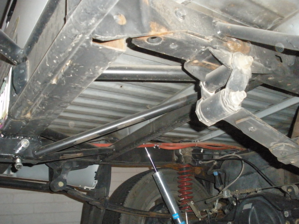

With all the texting and cell phone usage, I had to reinforce my rear frame and rear bumper.....so,logically, the spare had to move. It had to go to the bed area but not effect the utility of the bed space itself and I think that was accomplished. Here's the reinforcing that happened under the bed....the frame is also boxed. One pair of tubular bracing is going directly to the receiver hitch
