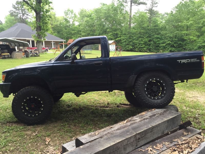

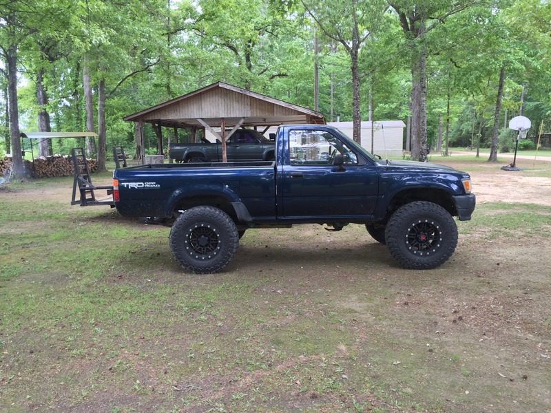

Stuffed the rear to get measurements.
17.5" compressed and 24" extended. Wanting to add some 5.5" - 6" shackles for the added weight of spare tire and rear bumper
