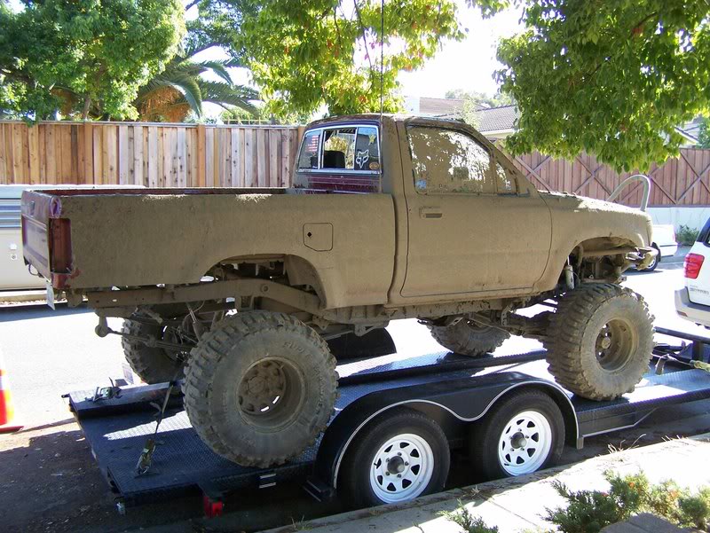

You could go the universal route and have shocks like mine..
20" compressed and 36" extended. Universal Rancho's BABY!

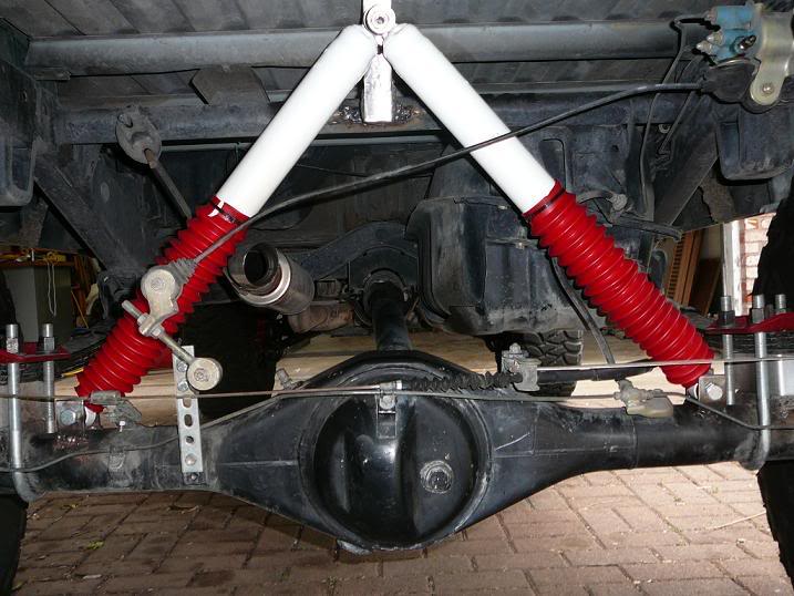

sorry to go off topic a litte but is this the way the front boomerang shackles are supposed to go?i installed mine the opposite direction.Name:  a100_2382.jpg
i think he has them on backwards, the reason for the bend in the shackles is to clear that body mount not hit it
