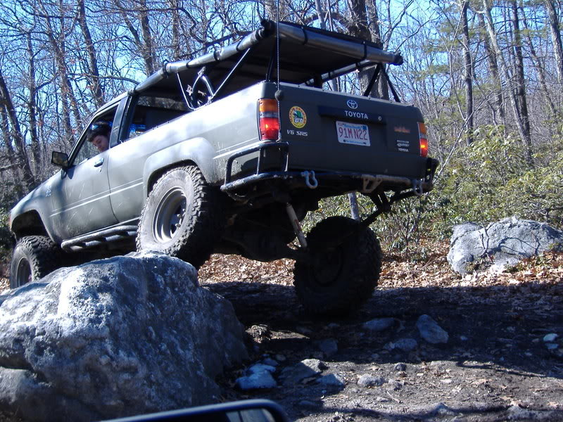

i flexe mine and measured...it was 18" fully compressedand like 38" full drop...my shocks are 17.25" collasped and like 36" fully drop...they are also tirangulated
and no...that pic is nowhere near full drop

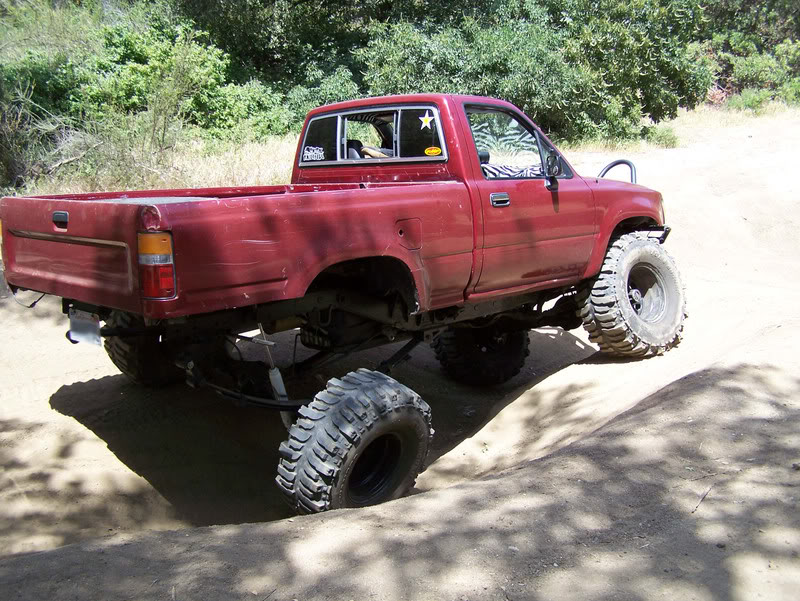

oh no im running a skys offroad sas kit up front i think they are 5" springs. with shackles.
whats wrong with running double shackles?
it helps out with the flex.
i dont know how much that is but it is a lot.

yeah thats a crapload of droop. i could picture the shackles collapsing in the opposite direction but i donno ive never actually seen a double shackle setup
