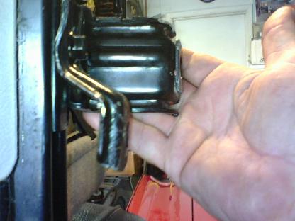

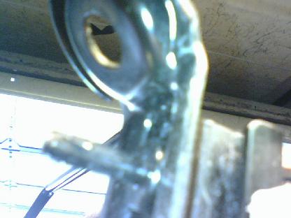

Wasn't raining today , so I decided WTF, lets get this rolling here ! First pic shows the reason for the swap... 22 years and around 350k miles on the poor stocker ! Second pic shows the locating peg that I removed on both front side mounts,, and also the way the front tabs have to be bent to match the angle of the Toy seats... or close enough !

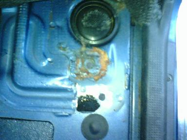

Even found enough goodies under the drivers seat for a quick lunch as I got started !! And enough change for a 6 pack of refreshment after wards !! Then 2nd and 3rd pic here shows how the front holes line up, followed by the new holes for the rear mount compared to where the stock ones are.

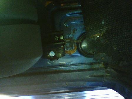

Rear mounts
Now on these 2 holes , the inboard one I drilled appears to have something underneath it, will take a closer look tomorrow when its not as windy and blowing all kinds of crap around my driveway ! Thinking its just the shield for the cat . Also trimmed away a bit of a rib that was by the outboard hole... so the seat mount base sits flat .

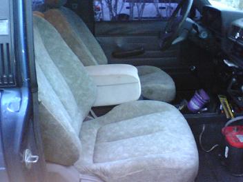

Installed...
... look great and feel really great ! Drove it to dinner tonight and do sit a bit higher then before, which is great ! I attribute that to them not being old and worn out, nice solid feel and lots of support from them. Just need to modify the high passenger rear mount a bit ( above pic ) , but no biggie. Afetr I looked at the passenger seat, I suddenly remembered how it is different from the drivers seat in regard to the apparatus for the seat release, so I didn't molest that seat at all for the project. Now to move on to my sr5 panel upgrade, still looking for a nice cluster to put in. Anyone have one ... 88 or 89 4 cylinder .
