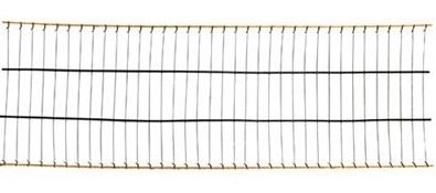

I found a product called Flex-O-Lator, which comes in various widths and lengths up to 50 yards. About $12 per yard for 12" wide.
FLEX-O-Lator
