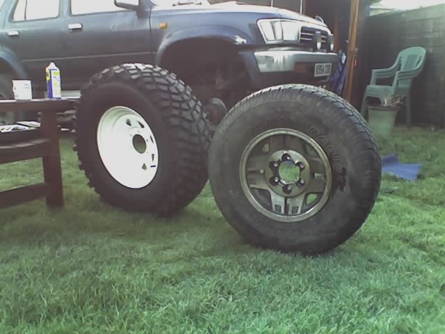

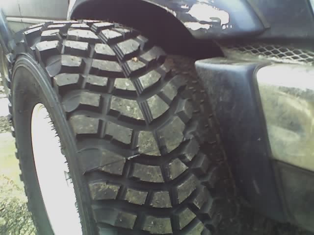

My standard tyre is 31''. Recently put on some mud 33'' with suspension and body lift. Used them wheeling over the holiday.
I have stock 4.1 diffs (2.4 Turbo diesel). Fuel economy was about 25% worse, poorer acceleration and noisy.
The 31'' are back on till I get enough cash to sort the diffs out. The 33''s go back on when wheeling.
Couple of pics showing the tyres I use.
