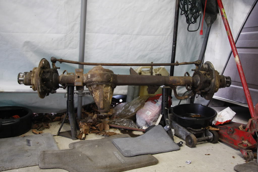

Good sound advice. But I say if it makes you feel good go for it. I have been toying with the same thing for years. This axle after 6 years is up on a table and ever so slowly getting rebuilt.Name:  _MG_2918-1.jpg
