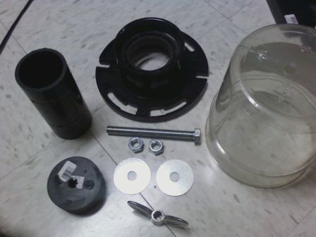

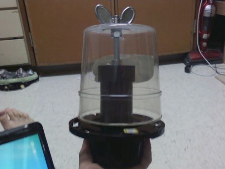

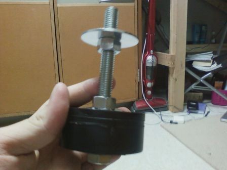

made my snorkel head in about 20 minuts and it was about $15.00 for all the parts......... i made it to mimic the new safari ssnorkel heads.......i liked how it terned out ....what do you all think?

one more pic!
I like it too...
-Can you please make a "mini thread" of how it's made?
I'm Kind of confused about the air intake...!
