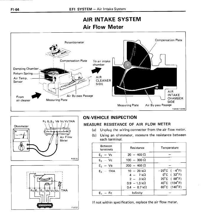

I got my new multimeter. Tested the vafm like
. It tested bad. I ordered a used one on ebay that the seller claimed was "good" in the description. It tested bad. I ordered a remanufactured one overnight from oreilly..........It tested bad. The original one actually tests better than the others. The truck still runs like crap with any of the 3 vafms plugged in and it runs perfectly with them unplugged. I guess I will send the two paper weights back and keep trying until I get one that tests good.
Original: E2-VS = 305 , E2-VC = .2 , E2-VB = 281
Ebay: E2-VS = 985 , E2-VC = .2 , E2-VB = 281
Oreilly E2-VS = 500 , E2-VC = .3 , E2-VB = 281
I was not able to pull codes by jumping pins T and E1 on diagnostic port. Took the cover off the ecu to inspect the circuit board. As you can see in the picture, the E1/E11 circuit was burnt in half. I got an ecu on ebay and now I can check for codes. the check engine light blinks continuously indicating no codes. At least that is fixed now.

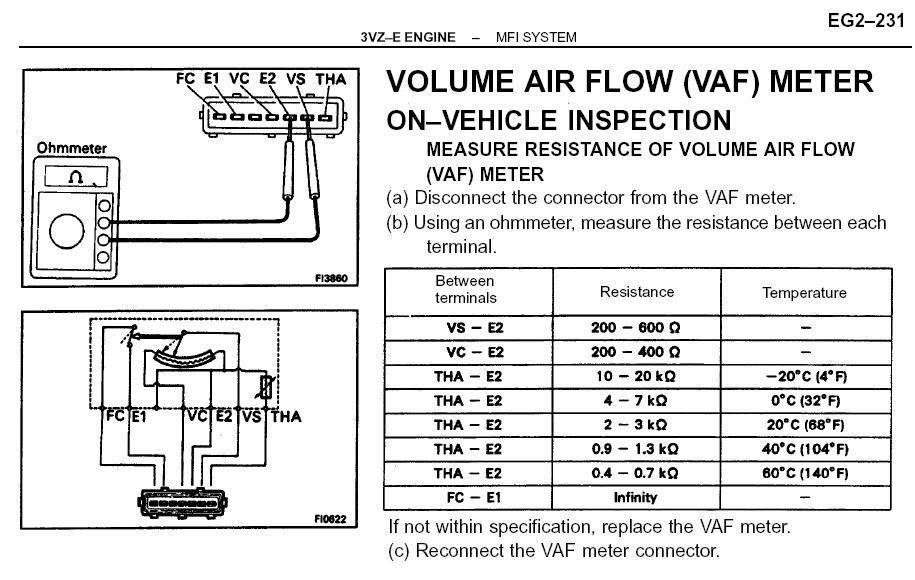

Well, the air flow meter test I was using above is for the 22re, which explains why all three units tested bad.
My original one tests good using this:
