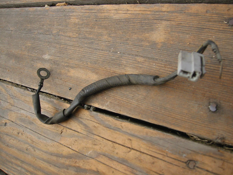

Originally Posted by runethechamp
OK, here is the picture of the wire. Can anyone tell me where it is supposed to go?
You have probalby already figured this out but it looks like the grounding strap from the air chamber. Somewhere near the firewall on the back side.

I bet you figured it out by now but just in case... The wire in the pictures is the grounding strap which attaches to a bolt on the upper left side of the left head between the second and fourth cylinder. The end with the connector attaches to the ignition noise filter (the plug) and a grounding screw on the left fender. I am hopefully dropping in my new 3 VZE in tomorrow and hope startup goes as well as yours. BTW, I pulled the tranny with the engine and reassembling the pair after replacing the clutch was about a 1/2 hour job with some swearing.
