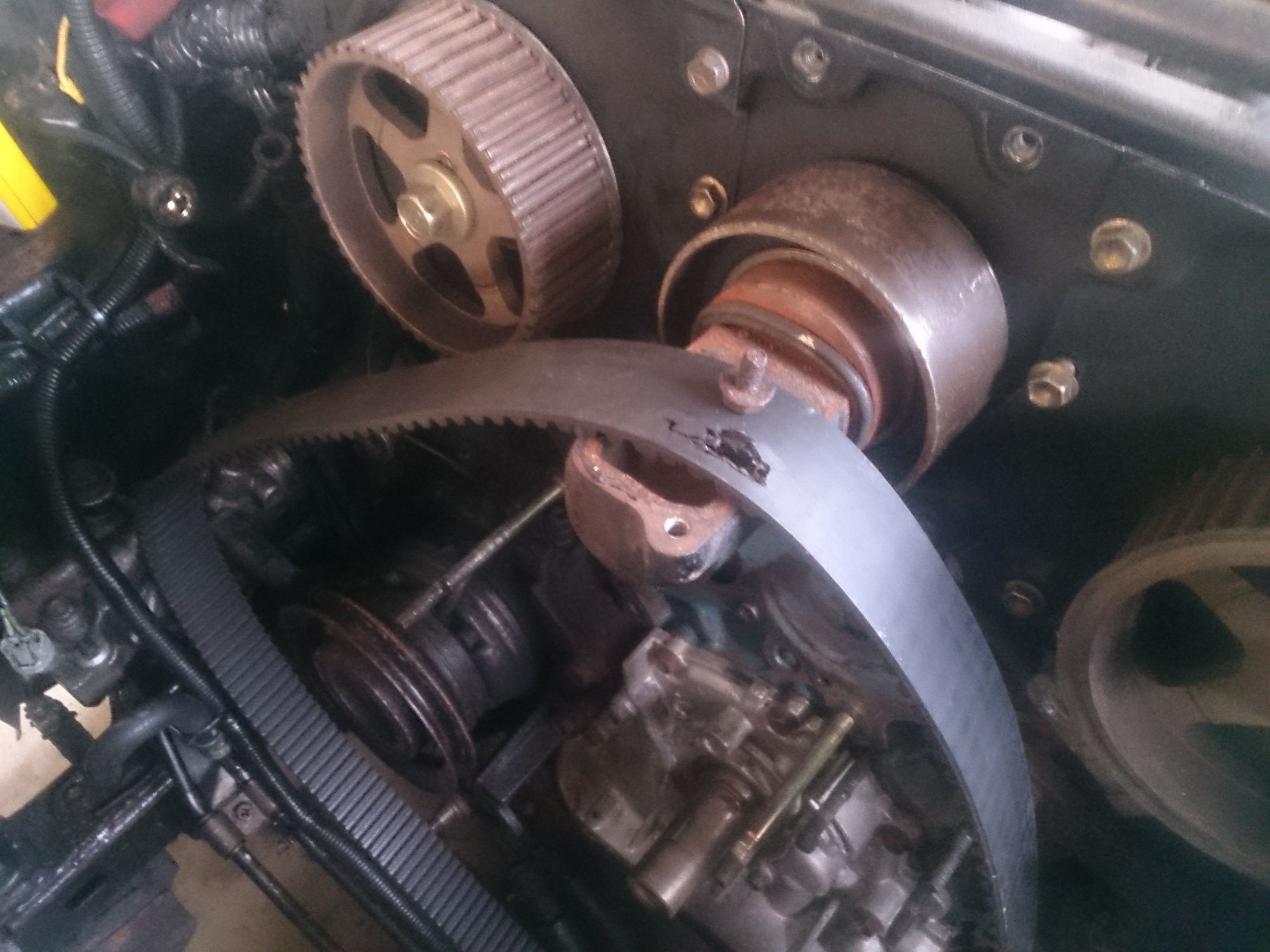

Originally Posted by ZARTT
Hi:
I rebuilt my V6 engine about 9-10 yrs ago.
I was careless when reassembling it, and this picture is the result.
I have no idea how long this situation existed, but as long as I can remember, the engine always made a weird sound from 2000 RPM onward.
Look at this and be careful.
Art
Damn! Thanks for the cautionary tale.
