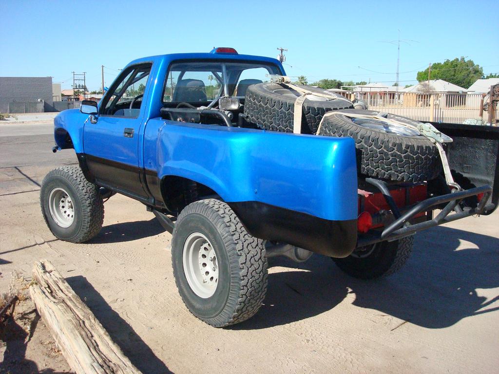

I was not implying mudflaps are real protection, just that they will actually stop rocks from hitting the sides of your pickup. I have done the same thing before on my prerunner, but I used a 2 part Kevlar epoxy bed liner. That will actually stop rock chips.

US Chemical - Defender Pro bed liner. It's a fairly new bedliner, it's only been out for about year. It's one of the most popular bedliners I sell, right behind UPOL's Raptor bedliner kit. Truck was just a simple desert truck, 3-linked rear strapped at 26". Score spec cage. +5 front race kit strapped at 17". Stock motor with Accel ignition, KN intake, full exhaust, geared and locked rolling on 33's.
