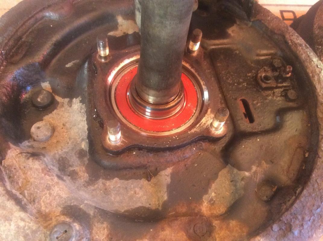

Axle Shaft Pulled Out
Hi guys,
Pulled out left side axle shaft and bearing play is in video below.... Confirmed bad? Will do right side after I buy something to plug the brake line.
BTW, I had to get creative to remove snap ring.
Gotta need the tool to re-install. Snap ring does not have the usual pinhole for pliers to engage. Pls see picture I posted ^^^.
Would someone pls post picture or link to proper tool I should get for this? TIA.

Got $8 exchangeable tip pliers from O'Reilly. Even the nicer ones still required a little creativity and aid from other hand and other tools, so cheap ones makes sense.
PULLED AXLE OUT
THIS WAS AFTER I WIPED THE LEFT SIDE CLEAN, BUT IT WAS CLEANER THAN THE RIGHT SIDE (FURTHER BELOW. Seal even looks good, no excessive gear oil outside this flange.
At first I thought mark said, "NGK". It's actually "NOK"! LOL!
